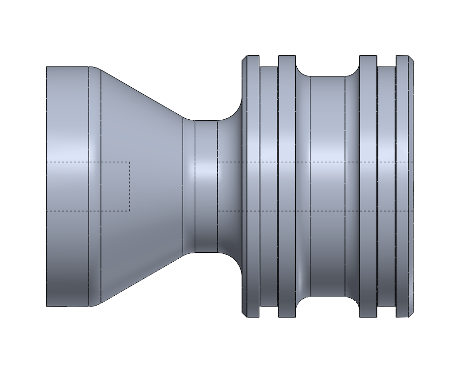

So here is where I am at the moment.
As recommended many moons ago I have added a large washer to secure the rubber face seal to the front of the piston. As before this is attached with an M10 screw.
Pressed into the rubber face seal is a sleeve to allow the screw to clamp the seal tight and not over compress the rubber
I have also moved the O-Ring grooves further apart.
Here is an exploded view for clarity :D
I plan on performing some more stress analysis on the piston before cutting metal, although I'm not entirely sure how to setup the analysis within SolidWorks (in particular what fixture face I should be using) - if anyone has any guidance that would be greatly appreciated.

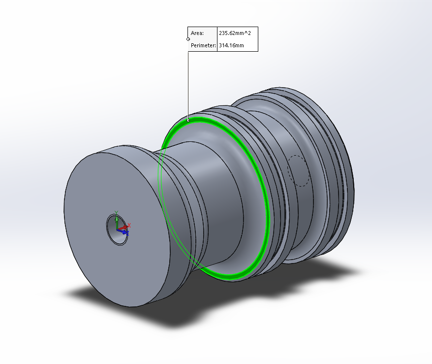

Something else I'd like someone's opinion on is the faces the chamber pressure and pilot pressure will be acting on
Apologies for the metric units but currently I have the following:
Chamber side of piston (235.62mm2):
Pilot side of piston (2019.46mm2):
I had a value of 1200 psi from HGDT for a 10x mix so I designed the piston to have a relatively small area to act upon (chamber side). WIth the current area of the pilot side (I can't really increase this) it requires a pilot pressure of around 133psi - from my calcs the pressure either side of the piston would equalise at chamber pressure approximately 1140psi.
Can anyone confirm this?
Regards
Stuart
Re: Thoughts on my piston valve design
Posted: Sat Aug 28, 2021 11:02 pm
by Moonbogg
Based on your shown areas, I got 1143 psi chamber pressure for equalization, so the same that you got. It looks like this is an estimate though because it looks like you clicked the surfaces and there are chamfers on them, so the actual diameters will be a little larger, but it should be pretty close as it is. It also depends on the sealing face and if the whole rubber will be against the port. If the rubber diameter is larger than the edge of the port, then the calculations won't be accurate as the equalization would happen at less than the 1140psi because there would be more surface for the chamber pressure to act on at the front of the piston.
Posted: Sun Aug 29, 2021 1:42 am
by stup86
Thanks Moonbogg
That does give me confidence that I'm on the right track.
I will double-check all the areas that the pressure will act on.
