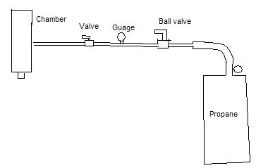

I like your hybrid man. I've been trying to find a good propane meter design, but I've failed miserably, could you refer me to one?
Extrusion
Posts: 147
Joined: Fri Sep 29, 2006 12:48 pm
Propane meters arent that hard just 2 ball valves wich the little ones are very cheap around here youll need a pressure gauge and torch head for the propane then hook um up like this...
Anyway i think you should lengthen the barrel there will be a big increase in performance lol ever thought of trying to break the sound barrier with this totally awsome hybrid?
Turn on torch and turn the first ball valve  when the guage reaches desired PSI turn off propane and close the first ball valve now open the second valve untill the guard reaches 0 psi then close that valve and fire lol<br /><br />Experiment with different psi's for the guage.

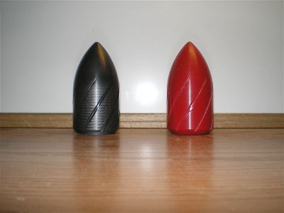

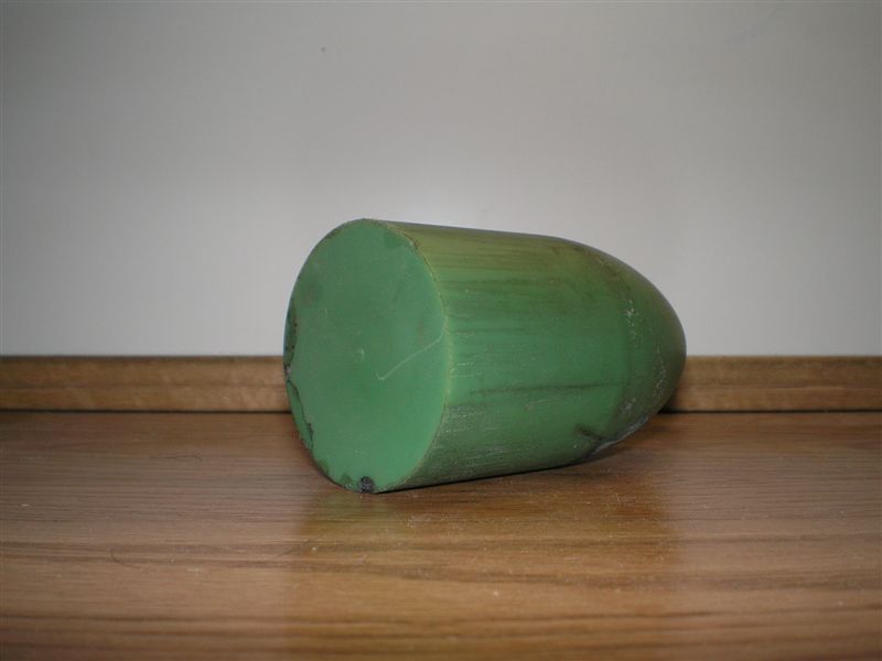

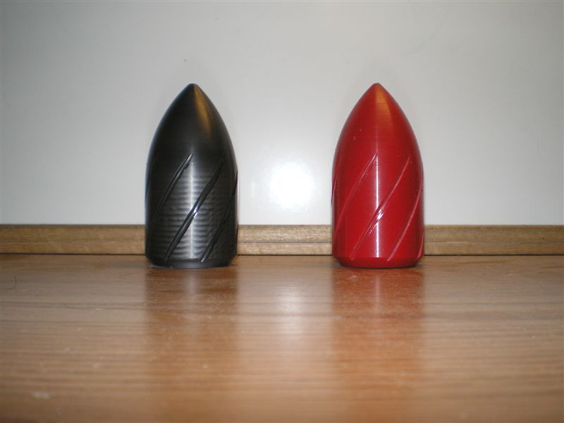

here are some pics of the nylon bullets that i use

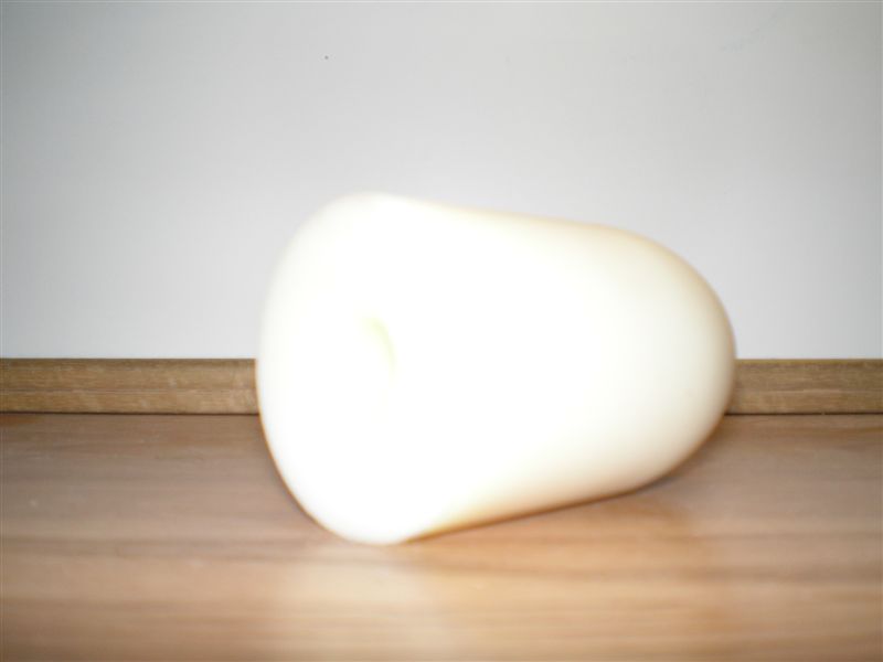

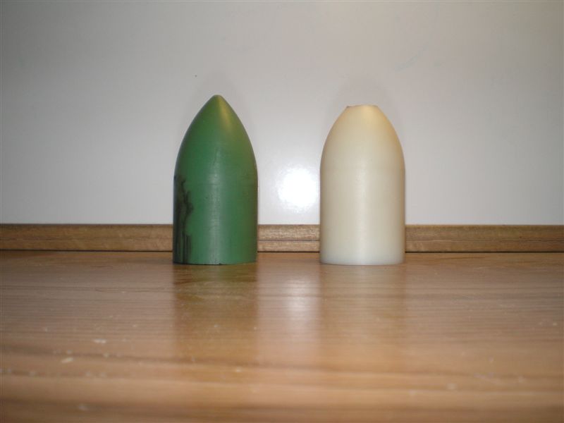

here are the older ones

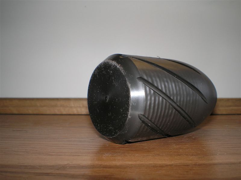

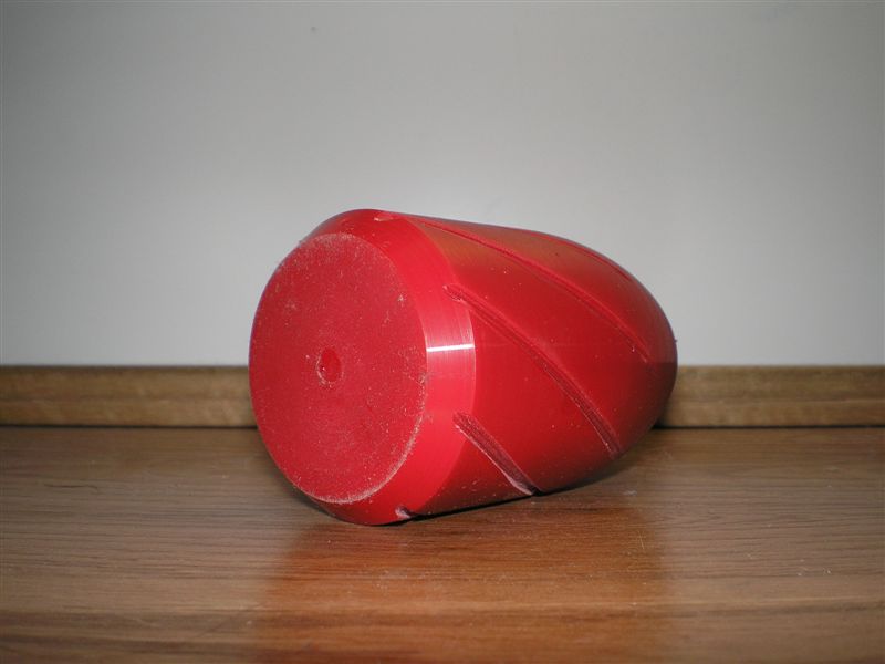

here are the new ones, they go a lot farther due to the rifling and tapered edges at the back

sweet, how did you make and rifle those?
reaper613
Posts: 75
Joined: Mon Feb 27, 2006 12:42 am
my cousin made them on a cnc lathe
