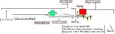

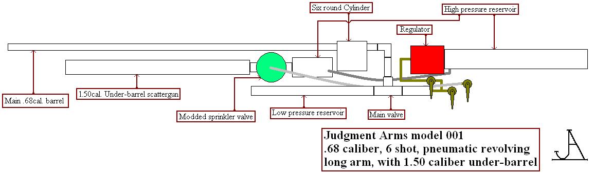

UPDATE:
Before I make the revolving rifle I thought it would be a good idea to make a smaller, single shot, version with an 18inch. And while I’m at it I’d see if it even needs to be rifled by comparing it to a smoothbore barrel of the same length.
Does anybody know what the specific gravity of a paintball is?
Now then, here is the plan for the biggin,
It is now going to be a LeMat (google it) style long arm
-Barrel: ¾ inch SCH 40 PVC, rifled, rate of twist =: 1 in 41, length = 36 inches.
-Low pressure/main chamber: 12-14 inches of 1 inch SCH40 PVC.
-Valve: undecided, most likely a chamber sealing piston tee valve.
-High pressure reservoir: approximately 20 inches of 2 inch SCH40 PVC, 12inches of which is used as the stock the other 8inches are under the barrel, connected by breaded hose.
-*new* 1.5inch by 18inch under-barrel scatter-gun fired by a 1inch modded sprinkler valve.
Picture is a basic sketch of the workings of the model 001(the name of the revolving rifle)
Questions, comments, and ideas are welcome.

The paintballs I have weigh about 3.4 grams. (Some weigh more I'm told), and have a diameter of 17.27 mm-ish.
That works out as a volume of 2.7 cm^3
Dividing: 3.4/2.7 = 1.26 g/cm^3
I assume those aren't the units you need - so go to google and type: "1.26 grams per cc = ? xxx" where xxx is your desired unit. The automatic calculator will do the conversion for you.

Would the answer to that be the specific gravity? Math is not exactly my favorite subject.
I googled it like you said but it didn’t work… I’ve got a friend who is good at math, I’ll ask him to convert it. Thanks for the info.

Yes. "Specfic xxx" means the "amount of xxx per unit volume" - so "density" in this case.
I checked the google thing with "1.27 g/cm^3 = ? oz per cubic inch", and a couple of others and it was fine.
