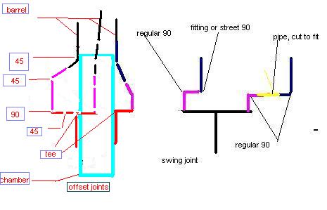

pyromaniac wrote:I will but i don't know how to move the barrels out. A 45 would be to much and theres no like 20 degree one.
post on the poll.
Although 20 degree fittings are not made they do make 22 1/2 or 1/16 bend fittings.
You will not find them in pressure fittings (dwv only)
2 other ways to do what I think you are trying to do involves making offsets and/or swing joints.
I'm hoping the crappy paint drawing shows the concepts of the design well enough.
The offset with 45's will resist the force of recoil a little better.
You can also rotate the top 45(or 90 on a swing joint) to make the outlet not parallel with the inlet. (giving your barrels spread)
You can also lay the bottom 45 at a 45 degree angle from level and glue your top 45 into it (saves 1 fitting).
If these concepts seem like they would work out your problems a trip to your plumbing supply store to get a bunch of small fittings to make a little model ofyour design would make it easy to get your final parts list
After you assemble your rig dry and unglued marking the fittings with a pencil or magic marker helps to assembly them lined up correctly.
Grey glue has a slower set and cure time, that might help you make some final adjustments easier .
Maybe canting the barrels to induce net spin would keep the net open and flat?
Maybe plugging up the individual barrels and measuring the water it takes to fill them up would get you close enough on the synchronized firing time thing.
I'm guessing this will not be a shoulder fired rig?
I hope this helps
offsets,swing jointsnew.JPG (19.03 KiB) Viewed 951 times
