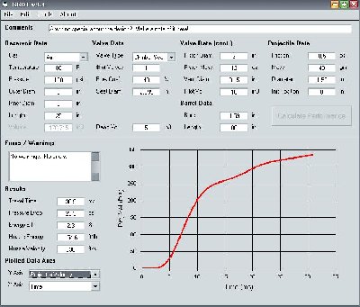

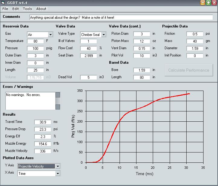

By the way, I think some of your GGDT numbers might be a little optimistic... the piston probably weighs closer to half a pound (8 ounces). My GGDT has a Cv unit next to the flow coefficient number, not a % sign like yours does... anyway, for mine, I plugged in about 23 for the Cv. I'm not really sure though; clide is good at GGDT, he could probably explain it much much much better than I could.

vent diameter is .25 inches, and pilot volume is 15 ci

Male quick connects have an ID of ~.20" and I would be willing to bet that the blowgun is more restrictive than that, but giving you the benefit of the doubt and using a pilot volume of 15 ci and .2" vent diameter, it is bumped up to 380 fps.

what is the seat diameter? and it is a moded blow valve
