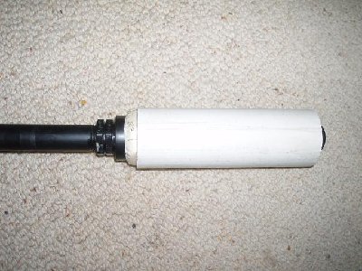

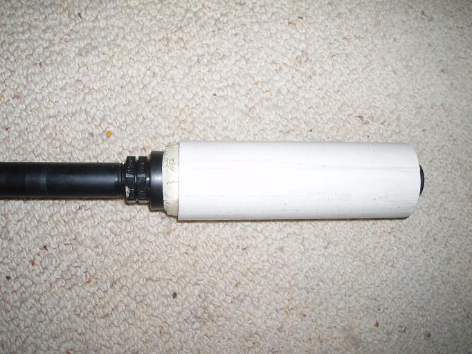

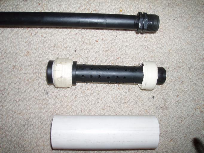

I just finished my knock up silencer using some 3/4 polly pipe with a 40mm outer casing.It works really well for what it is but I am going to attach baffels to supress the sound further till I find a good ratio or best silencing configuration.
Ohh and what design is your silencer now?Does it have baffels?I'm on a need to know basis here,as silencing is very trik.

I suggest you make it longer with slightly larger/more holes and have it separated into at least three separate compartments.rna_duelers wrote:I just finished my knock up silencer using some 3/4 polly pipe with a 40mm outer casing
im not using any baffles atm and it seems to work better than it did, but i got 3 seperate chambers inside the silencer not just the one anymore.

and I am going to add baffels to my silencer and it has 56 holes....Does it need more?lol and I would of made it longer but it's what i had at the time to work with plus it's only a knock up.
Isn't 56 holes in silencer 150mm long enough?and they are 4mmholes.

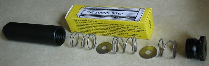

2) steel washers make ideal baffles, I use then in the silencers I make for commercial 0.22 and 0.177 airguns and indeed in most commercial silencers this is what you'll find. You can make them more effective if you separate them with springs instead of spacers, like the "sound biter" silencer attached.
