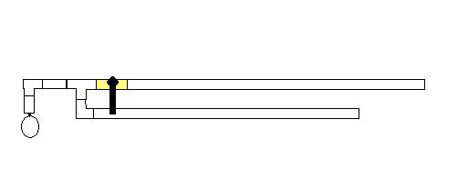

Hey I like your design and it looks like its going to turn out to be a really nice cannon. But I think it would look cooler if you flipped the stock around like this... but just substitute the valveb for whatever valve your using...

Acdcmonkey1991 wrote:Hey I like your design and it looks like its going to turn out to be a really nice cannon. But I think it would look cooler if you flipped the stock around like this... but just substitute the valveb for whatever valve your using...
actually, i think that looks better. Ill do it that way.
Thanks a lot everyone. I bought all the parts right now and im gonna start on it. Ill show u guys what ill look like when im done. Thanks
