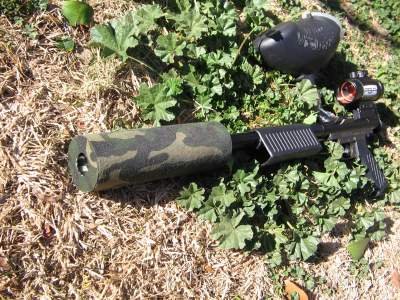

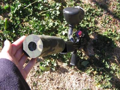

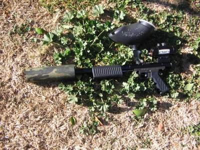

Man, I tried what you said to do with the spacers but it was too difficult to install, the aluminum kept on slipping around the side of the baffles. It was very irritating.
SO I kept it simple but I will make funnel baffles in the future.
Well, I tried to make a video but I ran out of gas and my camera made an error with the video I did manage to take and I couldn't use it :x I am going to the field today and I will make a video.
I ruined one the paintjob yesterday as well, I airbrushed a nice navy black on and then when I applied the clear coat it ruined it! all the paint when wrinkly :x So then I decided I would make a tough fabric cover. I used contact adhesive to bond camo fabric onto the silencer then I applied a clear coat of paint for protection and to seal it.
Check out the pics, I think it turned out really well.

That looks really good, well done. I am very impressed with the neatness of it, it could even pass as factory made :wink:
I guess we'll see just how good it is in the field then...

madtastic! that looks great Demon
