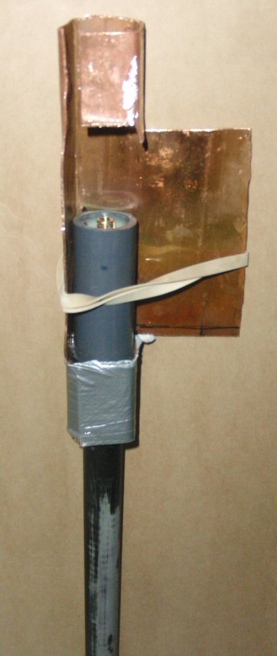

Some progress, the filler rig and small "valveless" cartidge should be ready for testing tomorrow, as well as the breech and barrel setup for the PVC hybrid cartridge. I decided to try my hand at some metalwork, flattened out copper pipe FTW :D

Update on these two prototypes:
- PVC cartridge breech: proceeding slowly but surely, this evening I should be able to test it for power and cartridge ejection with a makeshift bolt.

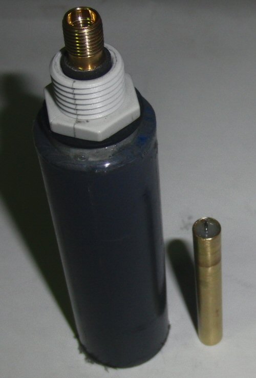

- Fill rig with a 6mm brass cartridge: I tried out the cartridge illustrated below, with mixed results. In terms of getting a hybrid mix sealed in the cartridge it worked brilliantly, however the seal will only reliably hold a BB for a 5x mix, and igniting this is not enough to pop it out. In any case, the short (2.5mm) external distance between the electrode and cartridge body means that for higher mixes the spark will arc externally anyway.
cartridge for 4.5mm BB approximately to scale

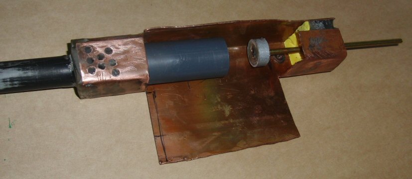

how high of a mix do you plan to take the PVC cartridges? I may have to try this over break..
may just pick up some aluminum tubing as well.
JDP12 wrote:how high of a mix do you plan to take the PVC cartridges? I may have to try this over break.
Not more than 8-9x, I don't want to push it too far.
Here's progress so far:

lookin good! Forgive my stupidity.. what diameter projectiles are you firing out of the PVC ones?
JDP12 wrote:what diameter projectiles are you firing out of the PVC ones?
3/8" ball bearings :)
