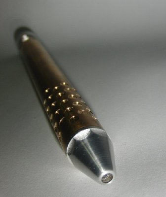

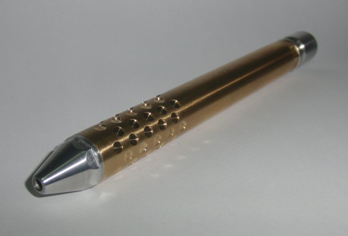

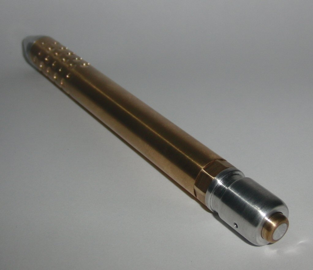

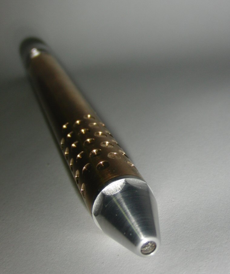

Cheers for all the positive comments, again thanks must go to LeMaudit for "twisting my arm" as dewey-1 put it and making my wallet considerably lighter
I would recommend this as a project for anyone getting into machining, I now have a much better idea of what designs should look like and have some grasp of basic techniques, and a nice little pen gun at the end of it too.
I'm waiting for an order of o-rings to arrive so I can try it out properly, it's all very pretty but pretty still is as pretty does
Edit: reglued the barrel, some final polishing, some better photos:
It actually is, but I took photos on a dark background...Gun Freak wrote:Not as shiny as Maudit's but hey what do ya expect.

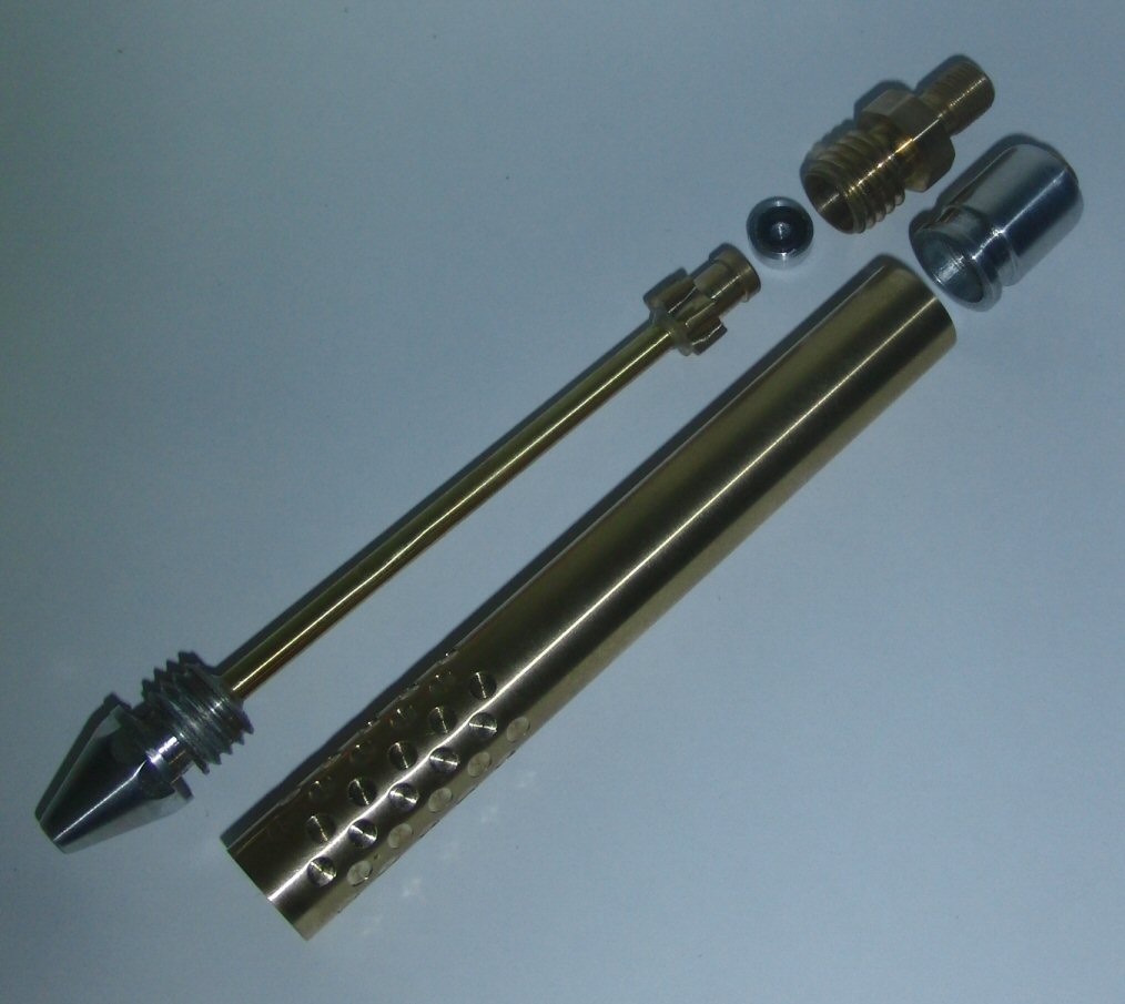

Very nice! I cut some small grooves in the barrel to help with adhesion but in reality all the epoxy is soing is sealing because the stress is taken by the shoulders.

Built to the measurements on LeMaudit's drawing, minimum wall thickness is around 1.5mm so it should perfectly safe at 1000 psi.
