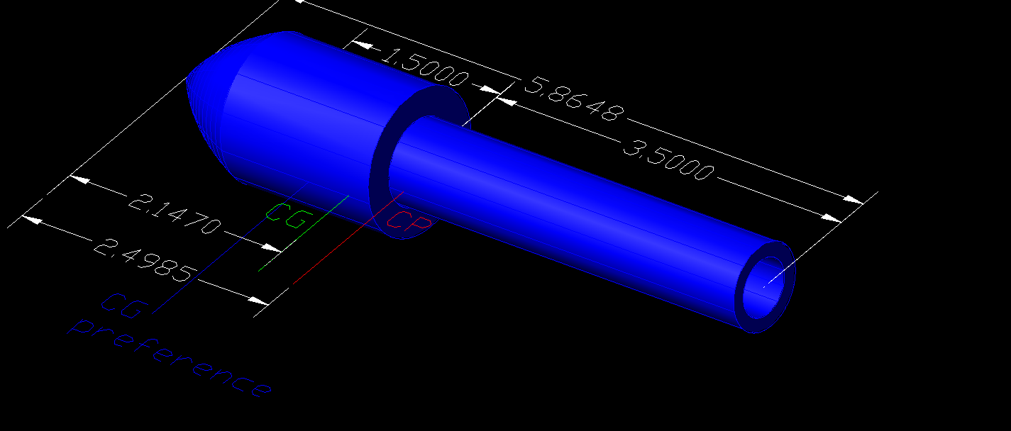

drex wrote:
the cp needs to be at least one body width below the cg to be considered stable.
Here is a quick drawing for nominal CG .

what program did you use for that drawing and cp/cg calculations?

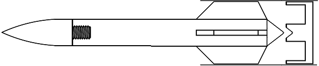

Why are we all using sabots? Wouldn't a dart like this with a o ring in the middle be best, reducing weight and friction, and giving a better seal?

shardbearer wrote:Why are we all using sabots? Wouldn't a dart like this with a o ring in the middle be best, reducing weight and friction, and giving a better seal?
As explained above, higher velocity and better aerodynamics.
When the military want to lob a large quantity of explosives over a short distance, they use that kind of design:
When they want to throw something fast and far (POLAND_SPUD, I hate living up to your expectations :D) they use something like this:

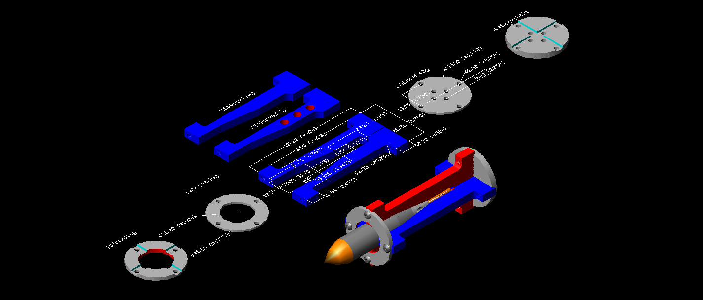

drex; I use an old 5 year AutoCad.
Here is the sabot with individual weights if I calculated them properly.
Impressive work Duane. You're right, as it is the weight is far too high. The material needs to be thinned out and drilled out :)

drex wrote:Would a sabot like this work? it seems to me it would be easer to make and lighter.
I like it! My only objection is the length of the rod which lengthens separation time.
I would make it like this, with full bore fins. That way, the sabot is lighter, the projectile is more dense and also more aerodynamic due to the pointy tail.
