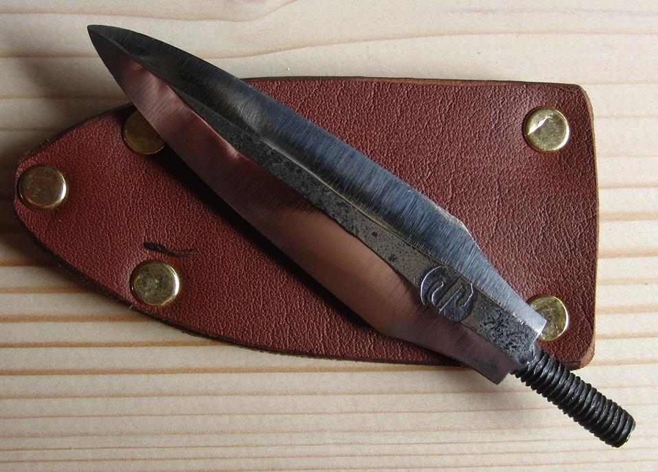

Look what came through the post today :D
Jake, I'm speechless, amazing work! I can see how much effort you put into this, thanks so much!
jakethebeast
Finland
Posts: 945
Location: Jakes cave
Im very happy that you like it! Its my first dagger blade, and for that i think its pretty ok.
