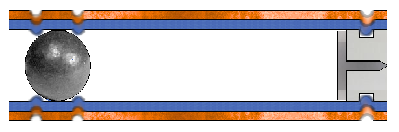

Um, it looks like that one won't seal... Gas can get from behind the burst disk to the gap between the projectile and cartridge, then on to the atmosphere provided that the projectile doesn't seal perfectly.
Of course, with a 'rubbery' burst disk it will seal, but as-is gas can escape without ever encountering an O ring...
LeMaudit
Posts: 665
argh you're right... damn... I need more coffee :shock:

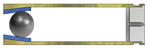

We could replace the theaded section and o-ring with a length of silicone tubing forced in a cone, as was the original premise of this thread...

I like that much better than the burst disk ones we've been discussing. Valveless is definitely the way to go. Loading it may be a pain though, especially if you want to use high mixes because the seal would be tighter.

For cartridges that need to be manufactured and reloaded in quantity, definitely.
A threaded plug at the back is still an option.

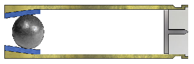

I thought through a possible design, quite similar to a regular firearm round. I'm not sure how it would work as the reloading of the individual shells might be an issue. If you manufactured several of these shells and varied the thickness of the cone tip on the end, you could fill them up to pressure and possibly store them "loaded." Just thread in the cartridge and fire. You'd probably have to make a reloading jig from a vise and a steel block with a conical hole though.
As to the fuel and air mix, the syringe idea, except with a sort of pump. Make a large volume mix and use the pump to pressurize the cartridge with that mix.
The light gray around the projectile is the seal. It's rather difficult to see sadly.
hybrid valveless 1.JPG (26.44 KiB) Viewed 3785 times

That is essentially what JSR has already constructed. The problem is in creating a cartridge that seals reliably, releases the projectile at the right pressure, and doesn't rapidly degrade when used.

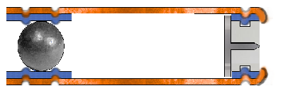

:shock: How weird... here's what I had in mind during the night :lol:
Using a length of copper tubing, a length of silcon tubing fitting inside, and some crimping to keep everything together.
In term of "mass" production it would be ideal.
The operation would be:
- Put the tubing in the lathe, ball side on the jaw
- crimp the lefter groove (a bit less deep than the other two)
- insert the ball
- crimp the other groove to keep the ball in place
- insert the plug (with a little groove in the middle)
- crimp at the groove position
- separate at exact length with the blade
You would need something like a knurling tool with a specific wheel shape:
Knurling tool
But it is much much more fun to design and build the tool, than to machine the same piece a gazillion times :D
This one cost $28; You would have to mill down the shank to 1/4" (or buy the 3/8" Sherline holder :wink: ), and make yourself a wheel in steel with the positive shape of the groove.
And... you would have a shiny knurling tool to play with, for the same price :lol:

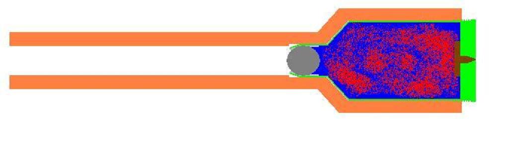

In my excitement I forgot a place for the spark :lol:
Alright, here's with two pieces of tubing inside, and a little crimping at the end to be sure the plug stays in place

Interesting thoughts. I wouldn't recommend that setup for the base plug, I have a feeling it would blow out.
Also, given this is going to be compact, I think I will scale up to 3/8" from the 0.22" I had in mind. Some designs/prototyping in the works, but first, dimples.
