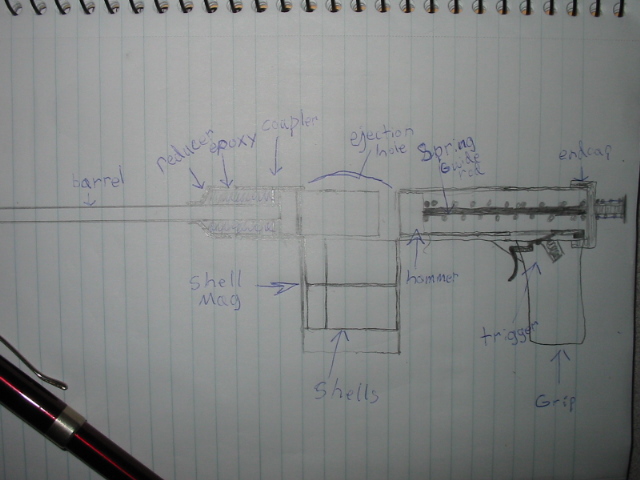

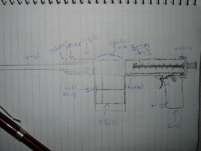

What I had in mind would work just like a simple blowback submachinegun - keep the trigger pressed to operate

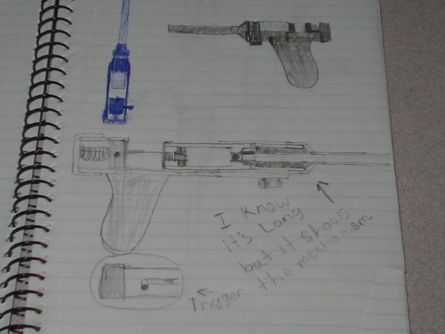

Oh thats a submachine thompson oooooooooooooo. I don't get the picture diagram of the gun.
Jack, is there something to be learnt from the whole stepped piston thing we had with the autobb? If you made a short fat cartridge, then as this disengages from the barrel, you've suddenly got a much larger face for the residual air pressure in your system to work on. So you could use a stronger spring, which would help pierce the cartridge.
Just a thought.

I'm very aware of this factor and certainly think it's to blame for the failure of this attempt to eject the cartridge from the breech.SPG wrote:Jack, is there something to be learnt from the whole stepped piston thing we had with the autobb? If you made a short fat cartridge, then as this disengages from the barrel, you've suddenly got a much larger face for the residual air pressure in your system to work on. So you could use a stronger spring, which would help pierce the cartridge.
Ideally, purely in terms of simplicity of construction (mostly the lack of concentricity worries) and aesthetics, I'd want the cartridge to be the same diamter as the barrel. However, this by definition leads to reduced air capacity and limited flow, and as you mentioned cuts down on the area avalable to the air to push out the spent cartridge.
With this design however, if I get the cartridge heads machined then I have no such worries. I'll speak to my machinist friend tomorrow and see what can be done.
