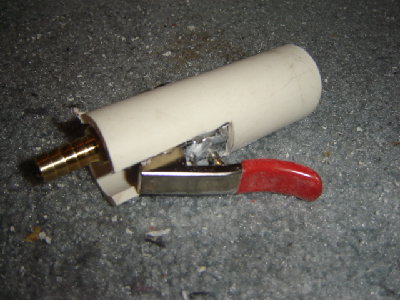

Does anyone know if those garden hose things work instead of an airgun? I have an old one on hand and wouild rather use that then buy one....
Those garden hose things (nozzles) may work but a blowgun would be better. The blowguns have npt, whereas the hose nozzle has hose threads. Plus, the blowguns are built to withstand the pressure. You may can find a hose nozzle that can withstand that kind of pressure, but it will cost you. Lastly, the hose nozzles are so much bigger than the blowgun.
If you are wanting the look of the hose nozzle, you could do something like in the picture and make it work for you.
Note: The picture is not my design. I found it on one of the threads on this site but don't remember where. I thought it was a good idea so I got a copy of the picture. (my pneumatic has this type of grip)
Edit: Make sure to post the finished cannon in the Pneumatic Cannon Showcase with good pics and maybe some damage pics. Can't wait to see it.
- The barb on this is straight but I used a 90 degree barb for mine to make the barb come out the back of the grip. This allowed me to put the top portion of the grip into a tee.
- blowgun handle.jpg (29.58 KiB) Viewed 1789 times
