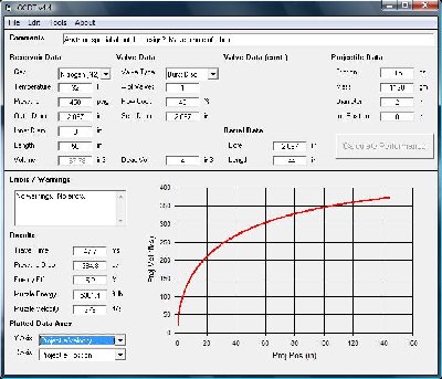

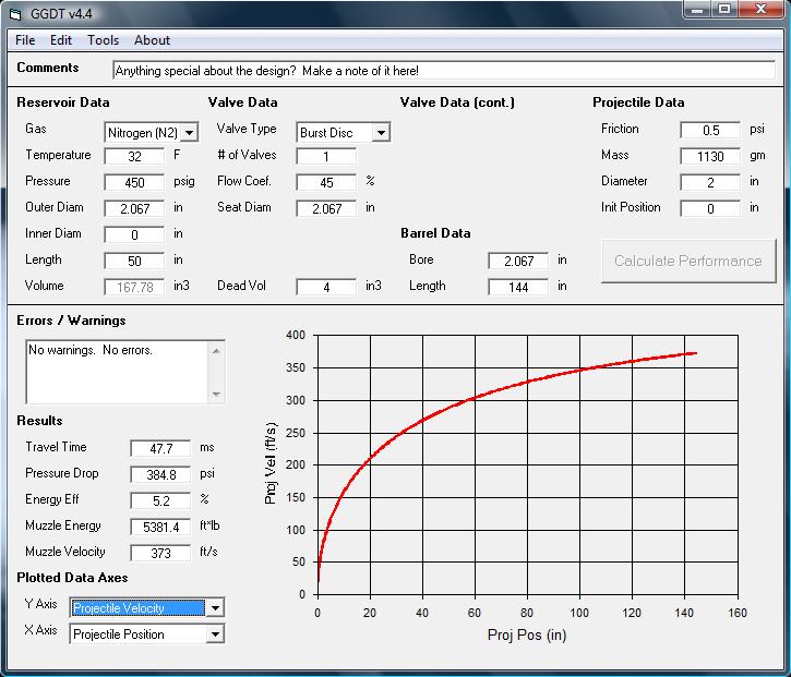

You don't have the option to export GGDT files in a format convenient for this forum, but most people just take screen-shots. This is from the steel ice-slug shot...DYI wrote: If you can show me how to post GGDT files, I'll show you the GGDT output for it. I don't actually have any close up pictures of the valve area.

Mark, that GGDT is close, but not quite;
The pressure used was 470, not 450, the dead space is more like 10+ cubic inches, and the flow coefficient of a burst disk valve is at least 50, possibly 55.
The most significant problems however, are the bore and the valve:
I used a 3" barrel for this shot, and you entered a 2" barrel. The use of a 3" barrel significantly increased muzzle energy for this shot.
Also, you entered 2" porting, while the porting on my valve system is only 1.61". This slightly reduces performance. (the union is ~1.9" ID, but the rest of the valve is only 1.61, and the flow is determined by the place with the least flow)
