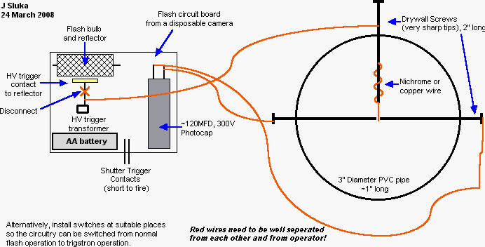

How are you holding your electrodes in place? Drilled into a short length of PVC? Wood is probably not good since it has too much conductance and capacitance.
You might try something like this untested wild-ass-idea;
1. Back the trigger electrode up by a half inch or so (away from the other two electrodes)
2. Take a couple inches of bare wire and wrap it around the threads of the trigger electrode and then stick it down between the two other electrodes. Nichrome wire (heater wire) would be best but if you don't have any then regular old copper wire should be OK.
3. As the sacrificial trigger wire burns up you can just screw it's screw in farther, or replace the wire all together.

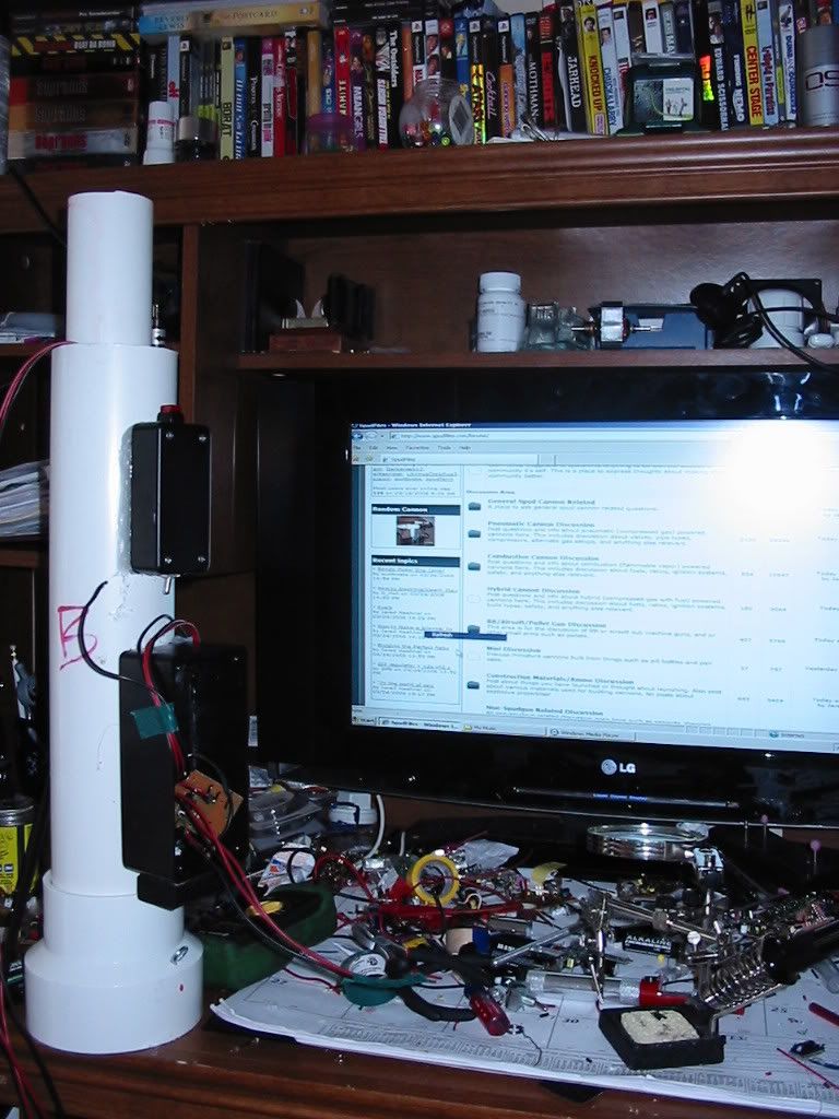

sparks in slow motion.. (lilke my song?)

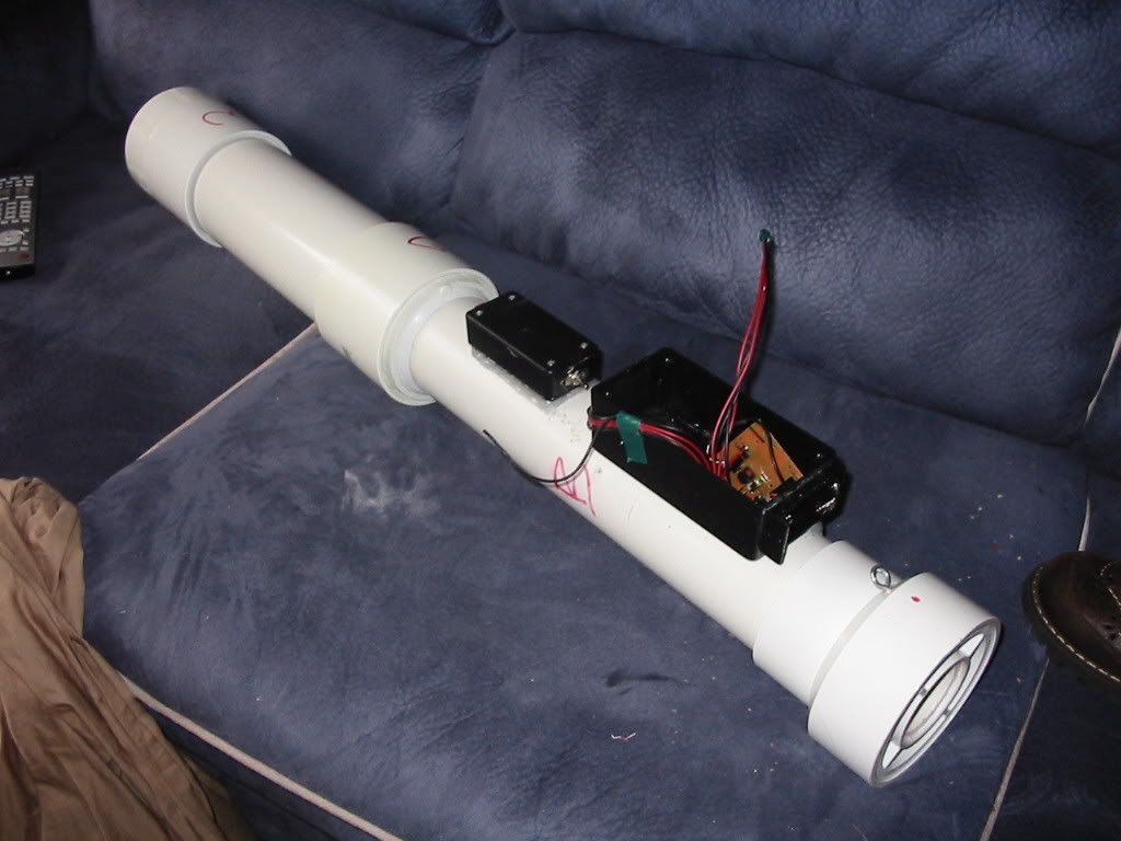

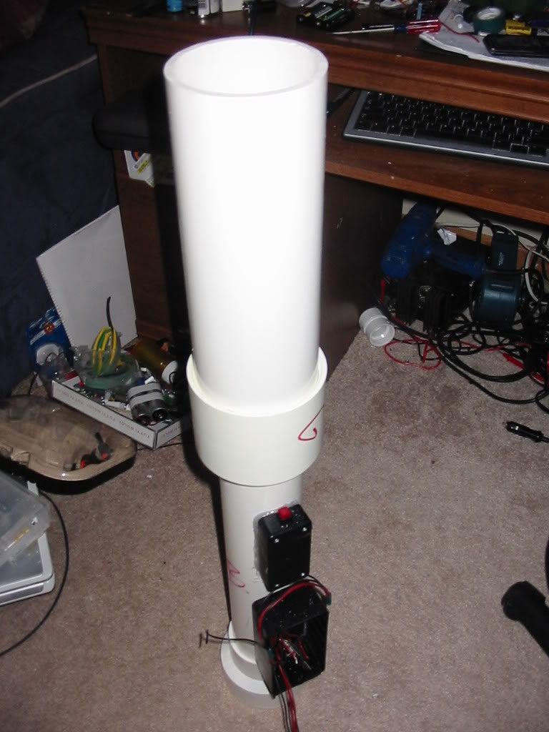

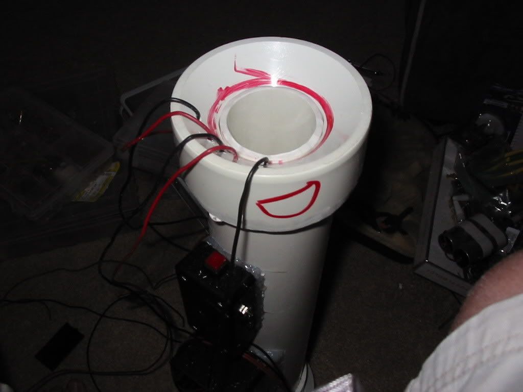

here is what is done so far on the gun itself...the wiring on the left will go to the spark gap and to the 12 volt exhaust fan.. the wiring hanging out in the right is the wiring to the L.E.D.s on the front of the gun.
also notice the sling hook on the right side..

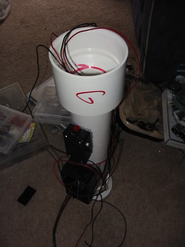

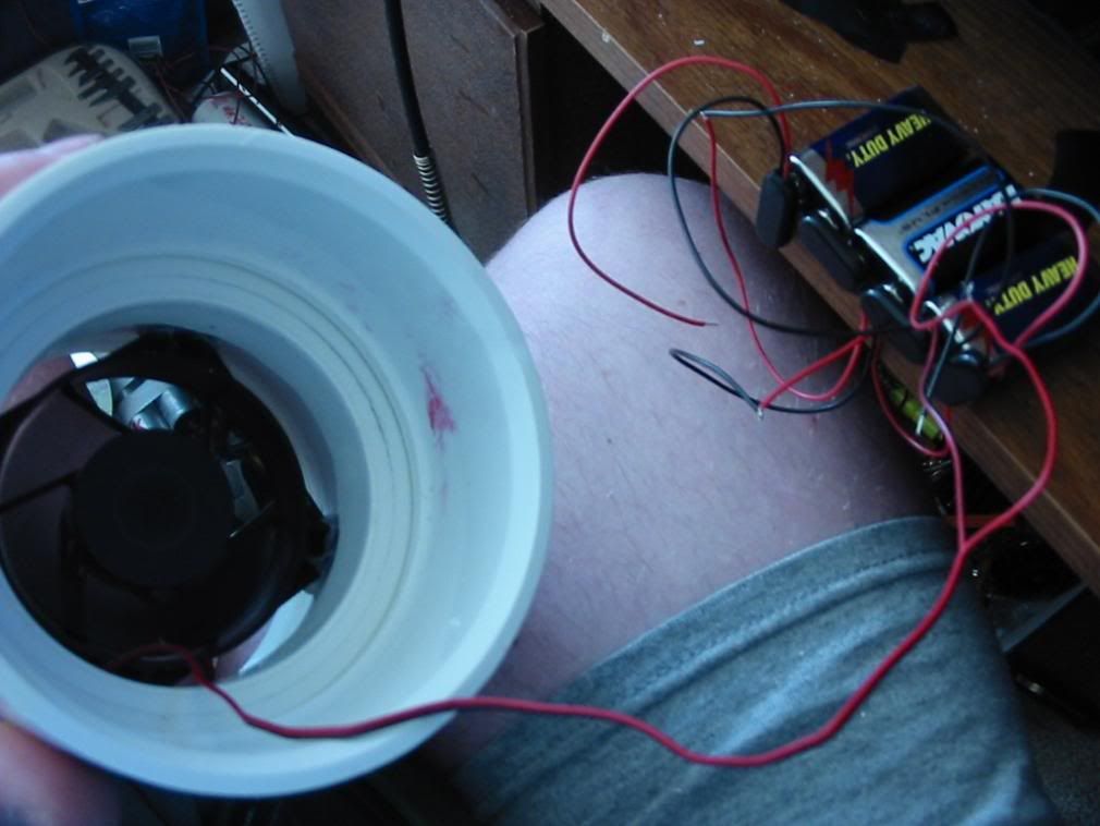

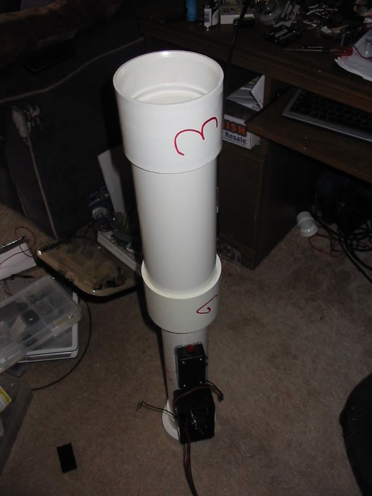

anyways.. here is pics of the progress so you know what is going on..

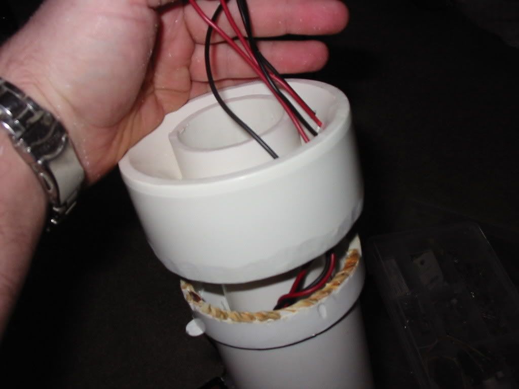

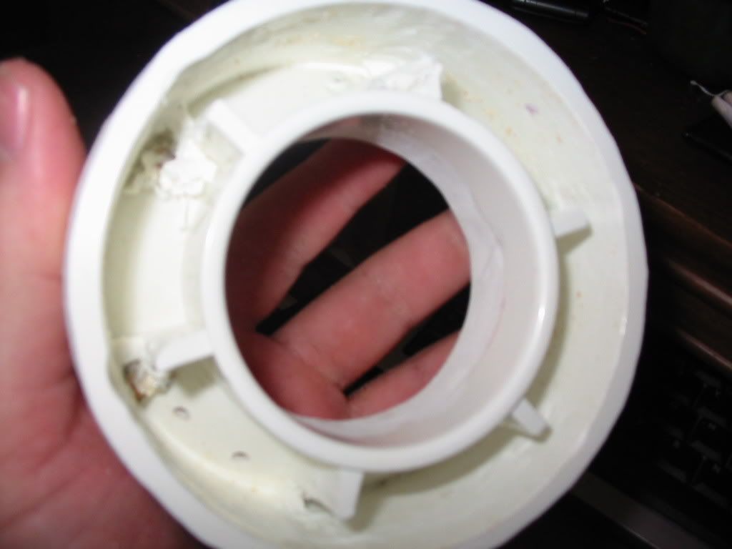

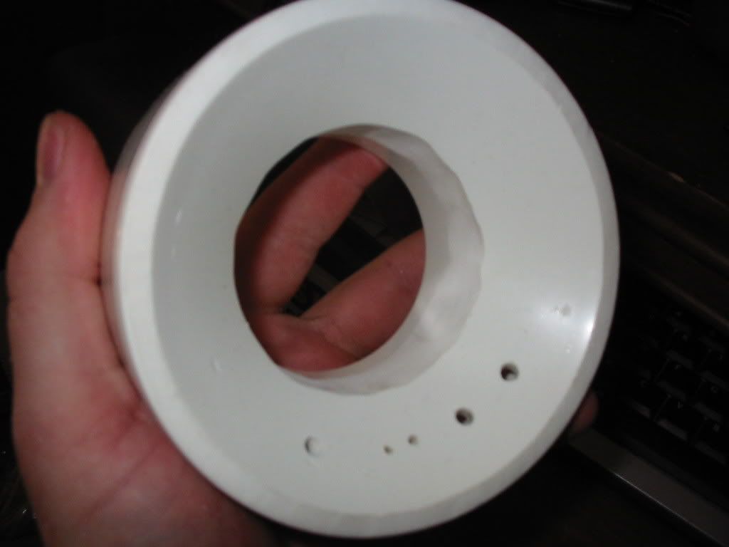

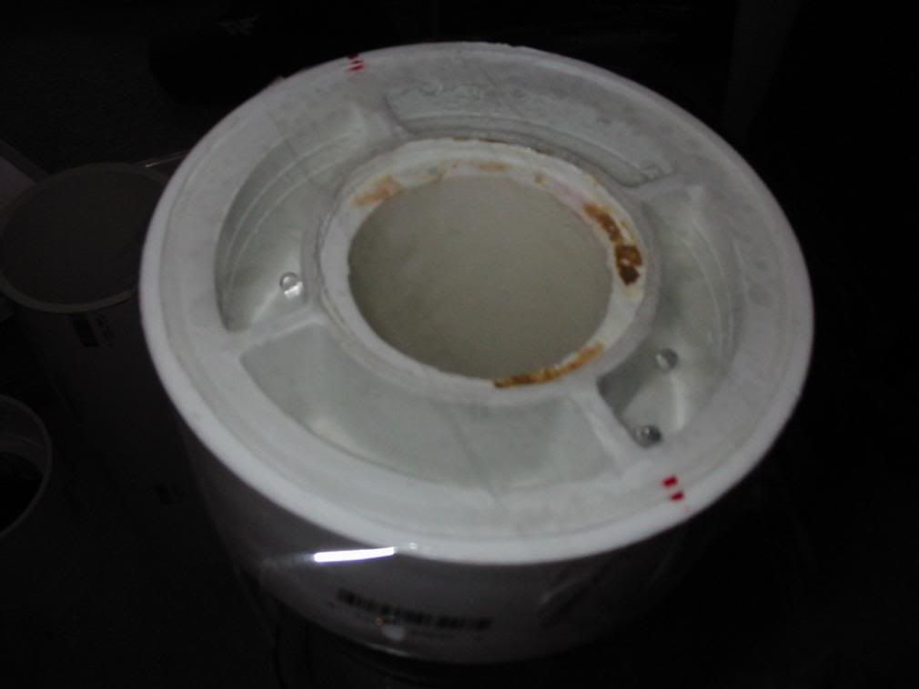

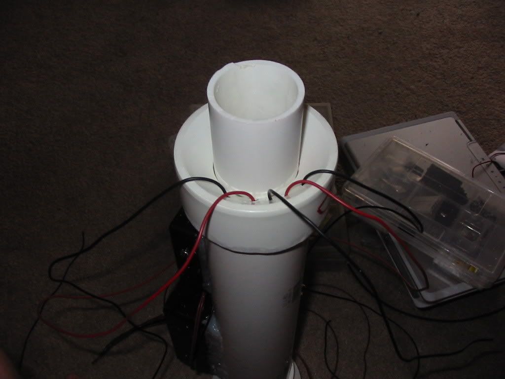

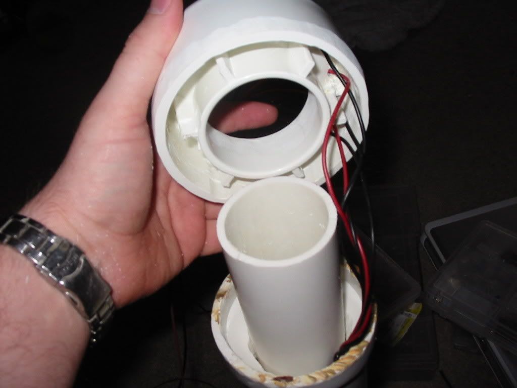

this is a picture of the flush reducer 4 to 2
that i am using to enter the wires into the chamber

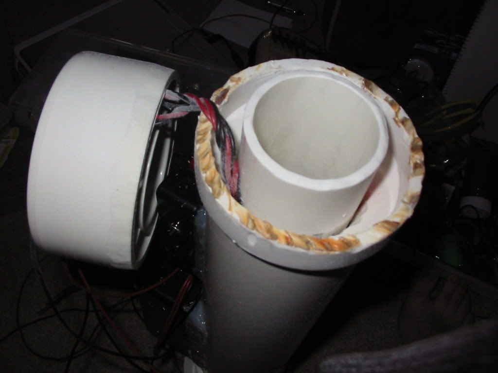

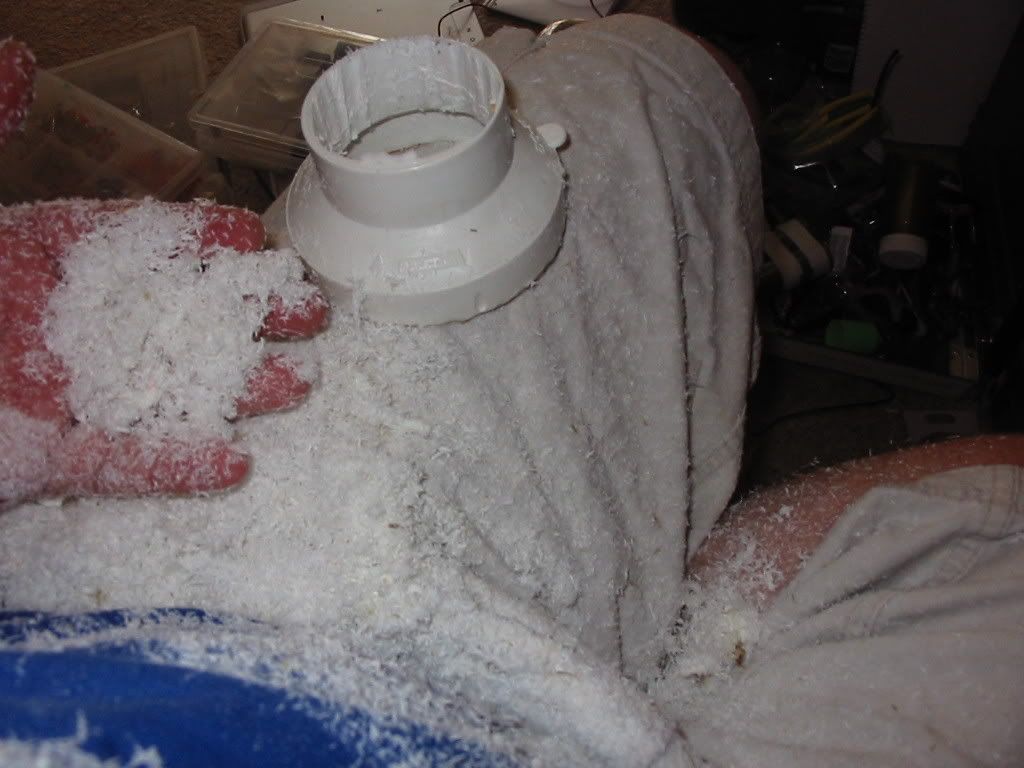

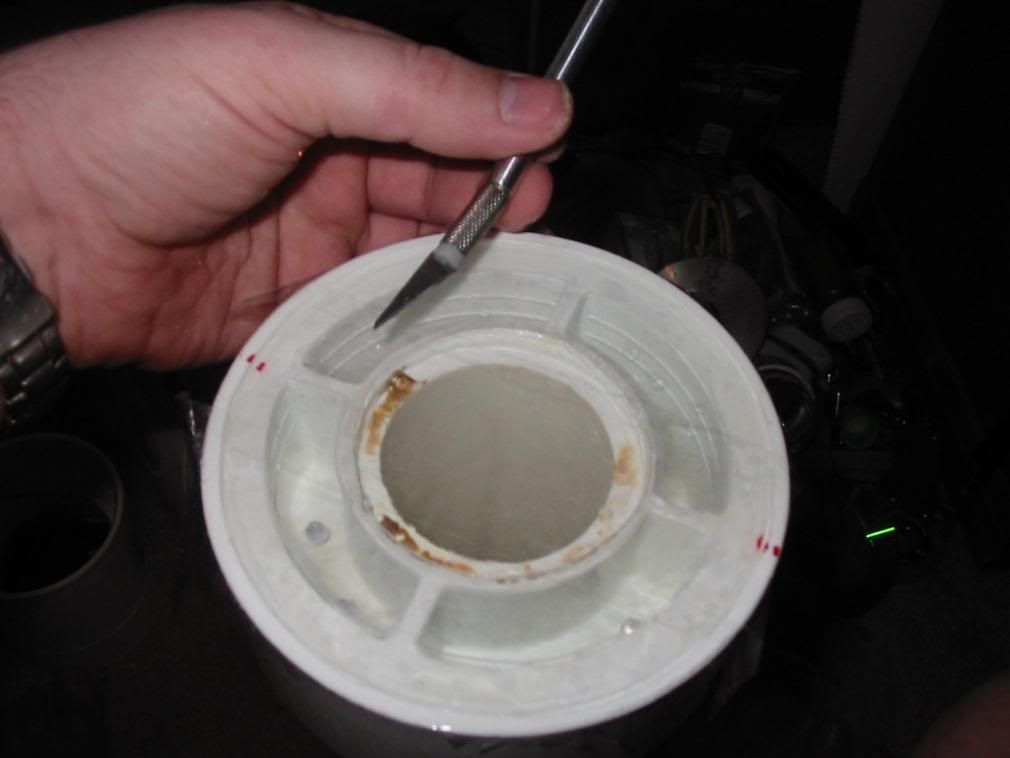

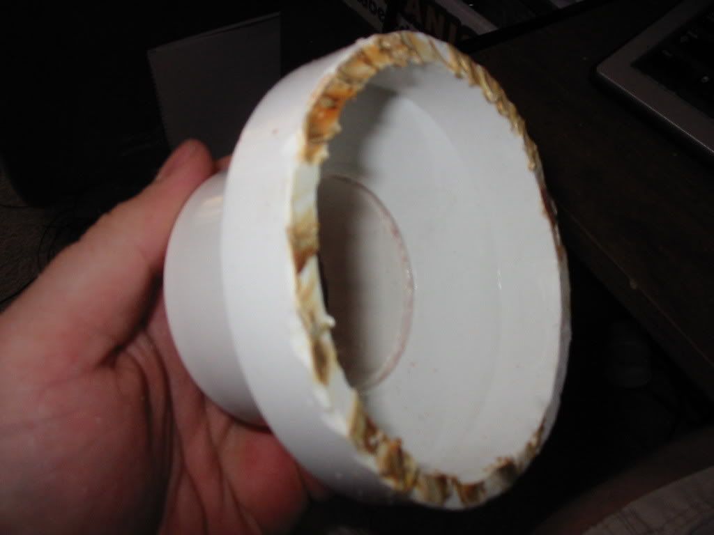

this is the back of the flush reducer.. notice that i ground around the edge breaking the supports for strength.. you will see why soon
this is a 3 inch to 2 inch reducer.. that I have trimmed down.. to fit in the flush reducers back... you will see soon.
look at this mess.. my ol lady is gonna be pissed... lol.. but anyways see how i ground out the inside of this reducer? this is the one above.. with the back cut off.
well this flush reducer is gonna fit over the 2 inch barrel.. and inside of the 3 inch sleeve covering all my wiring.
see it here pushed into the wiring sleeve? with the barrel extending towards the chamber
here is how good of a fit it made
now bringing the flush reducer back into the pic.. see where i am going with this?
see how the flush reducer and the regular reducer mate!
this shows you how my wiring is coming through into the chamber
nice clean fit.. entering the chamber

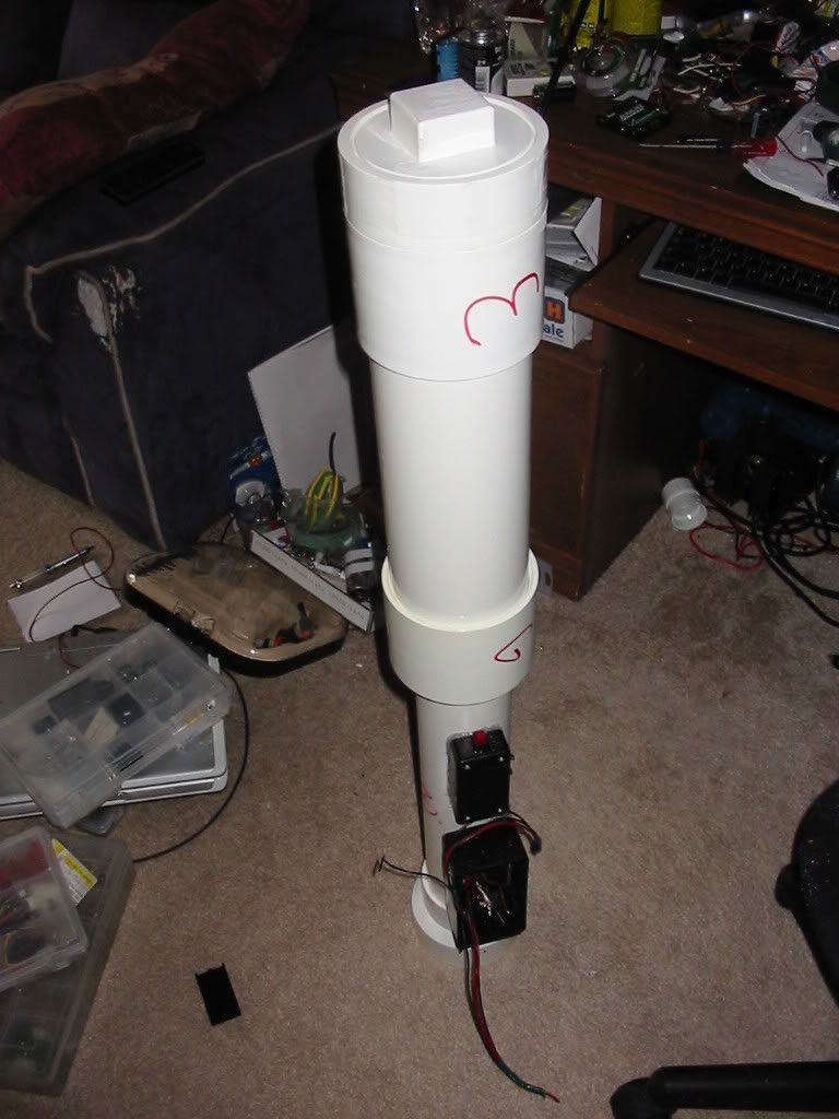

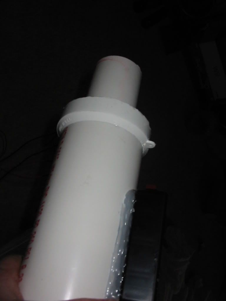

now i am marking and cutting off the excess barrel so the explosion will go straight out of the chamber
now i am installing a coupler to go over the flush reducer.. then to attach to the chamber

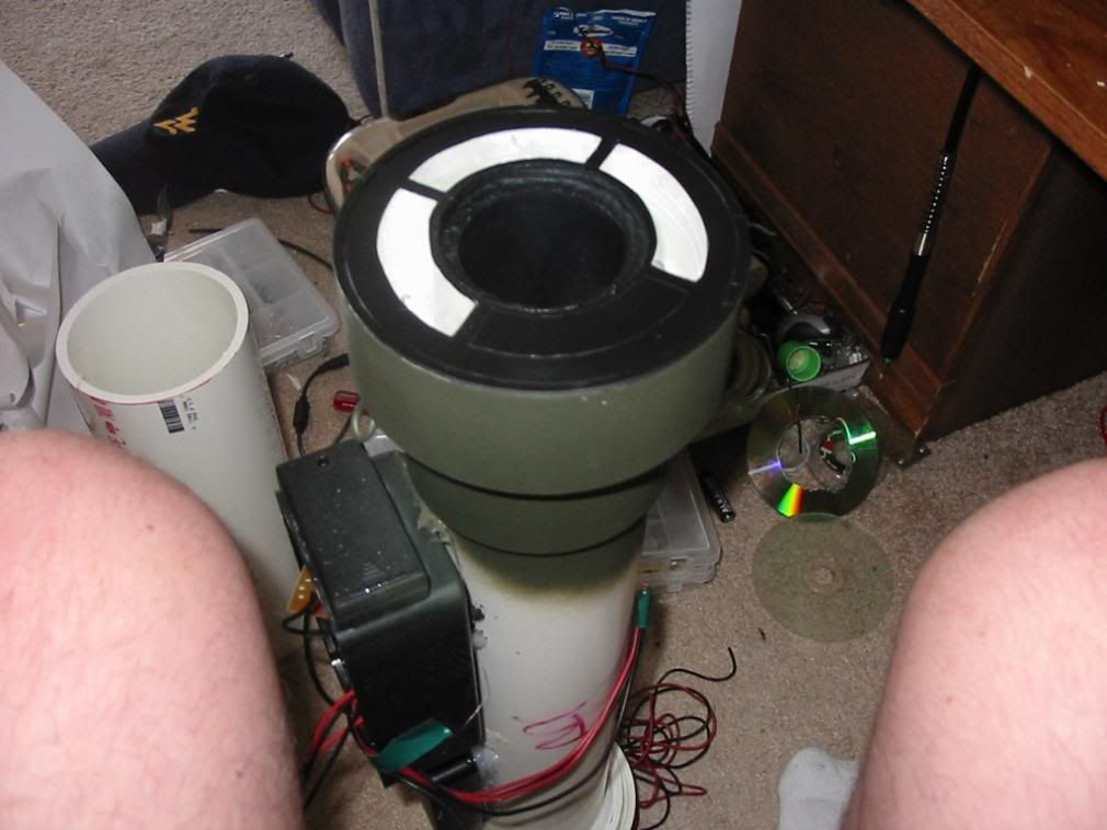

this pic shows you the chamber installed
this pic shows you the coupler for attaching the threaded cap onto the chamber

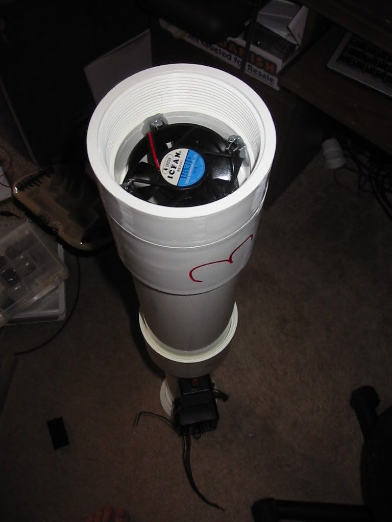

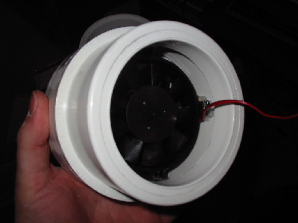

this is my exhaust fan.. and notice how the scrap i cut off the regular reducer was glued in on this to make a blast deflecter for my hot glue holding my fan in place.
here is the fan installed on the chamber
with cap on

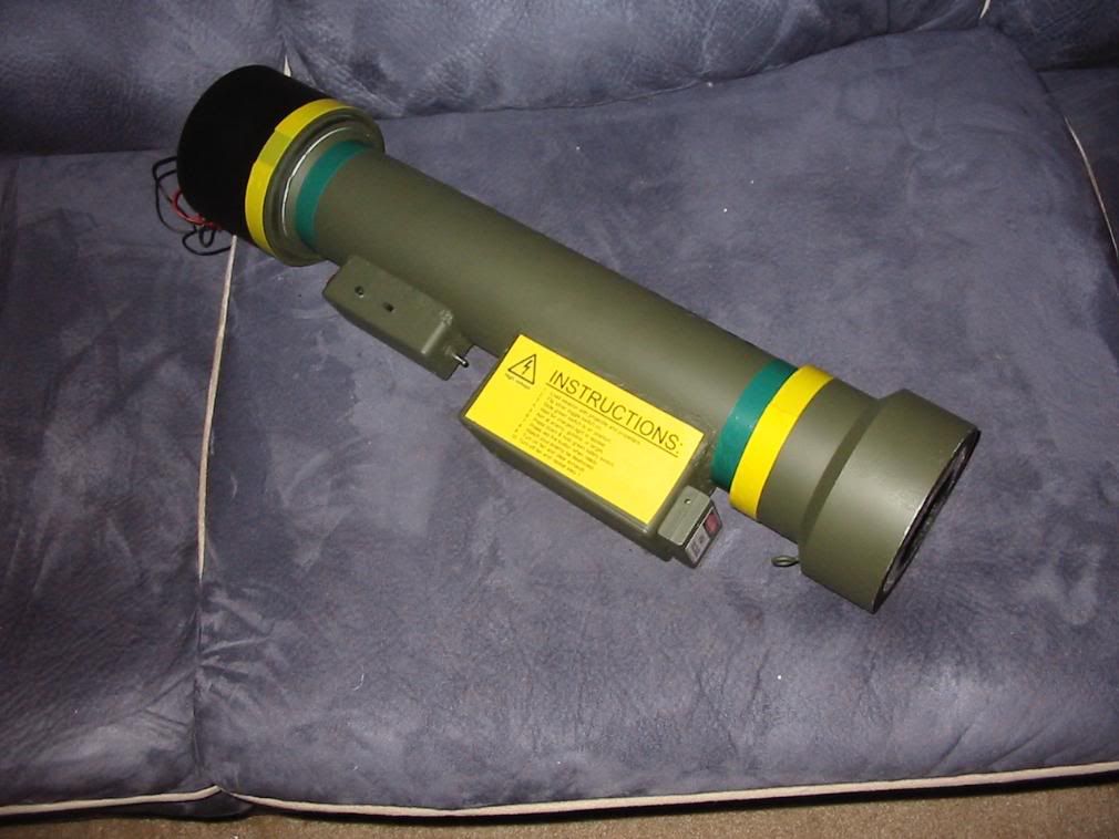

here it is on my couch..(what it will look like .... minus the paint.. stickers.. and shit

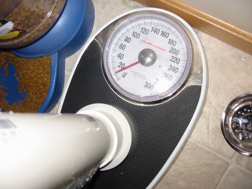

this shows you the weight.. as some of you always ask for some reason..
SO WHAT DO YOU THINK?

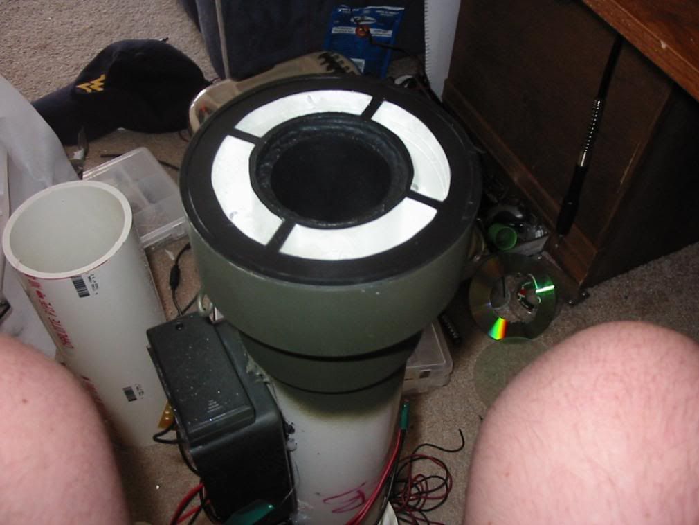

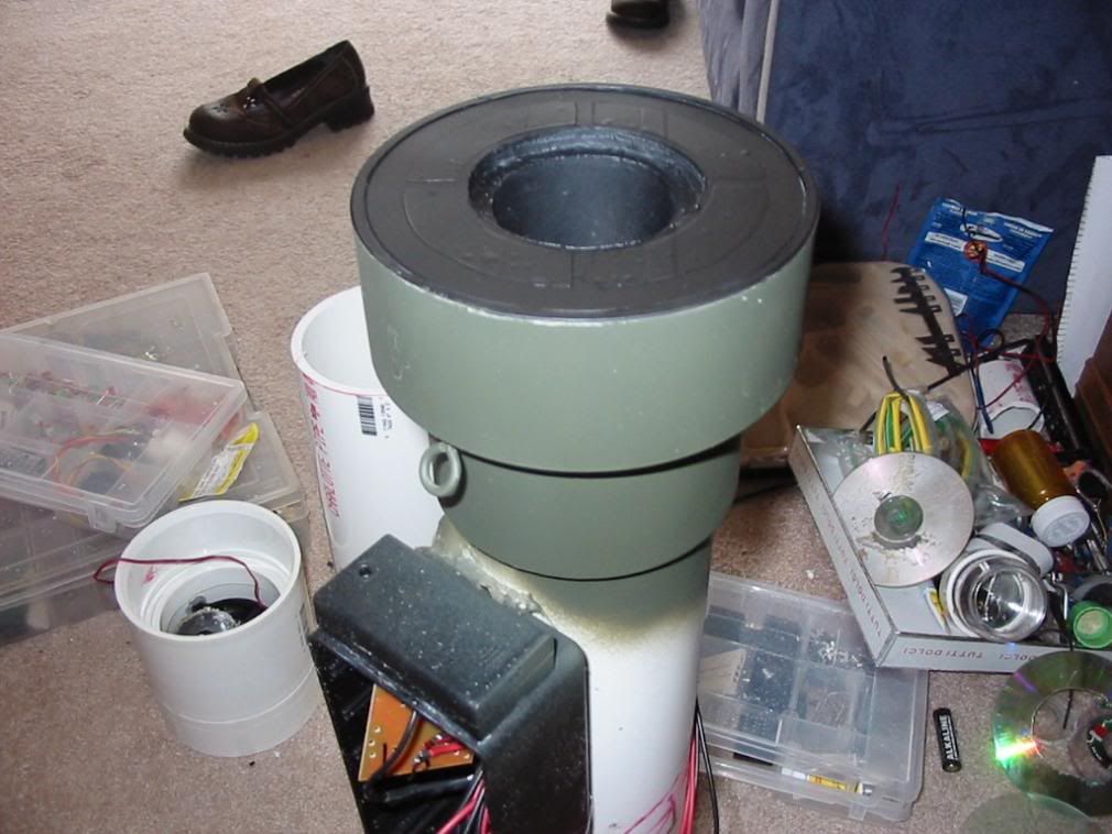

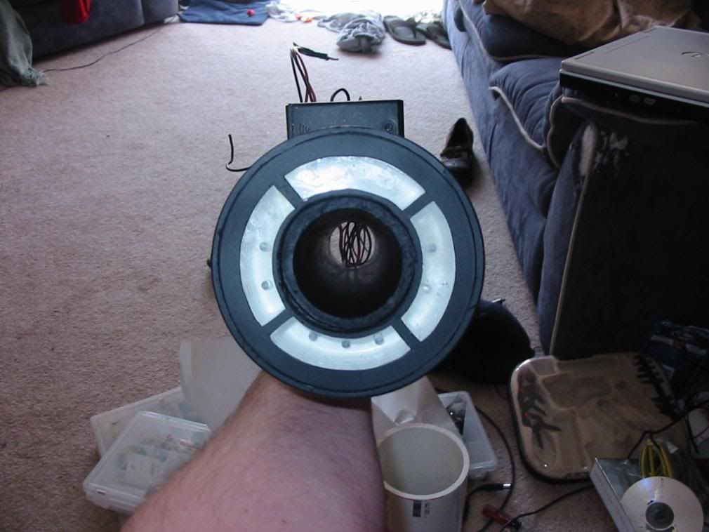

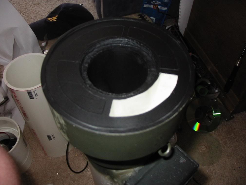

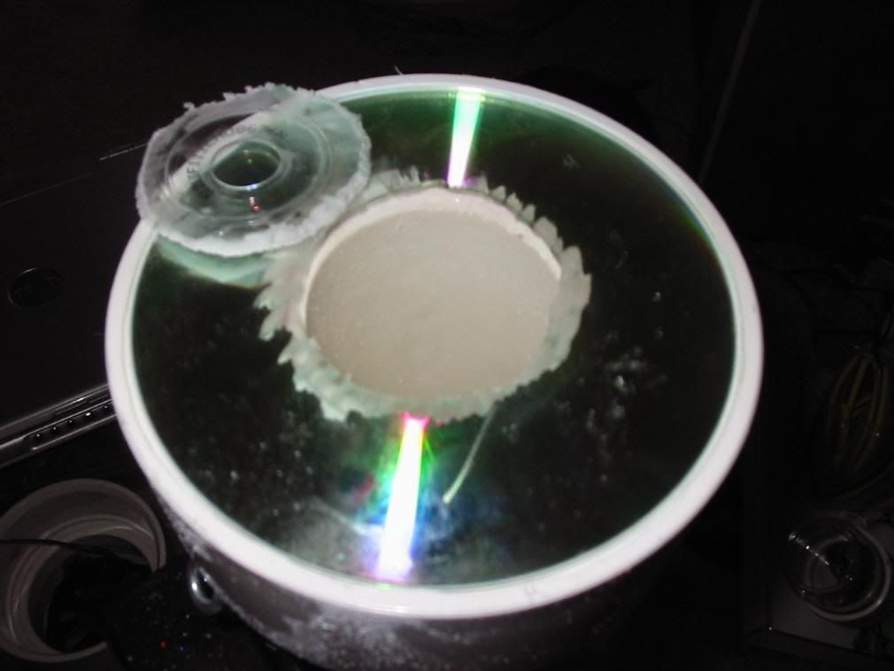

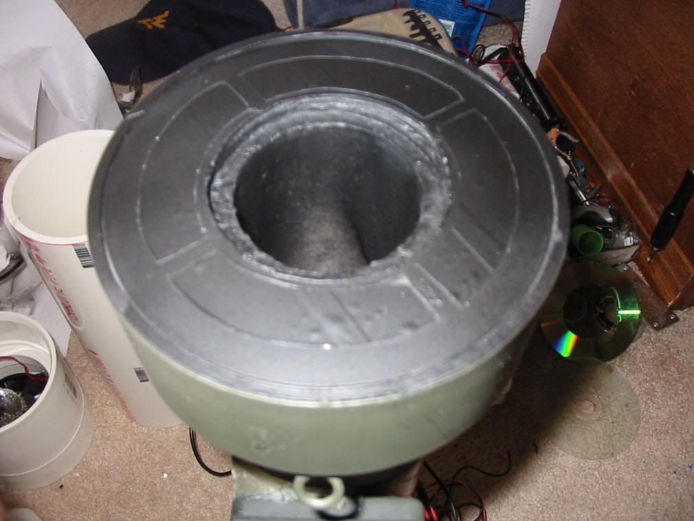

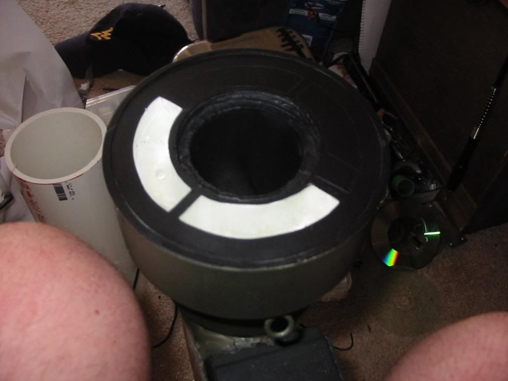

ill be a monkeys unkle did you know.. that cd is the exact same size as a flush reducer? 4 inch?
so i laid one on the thing and cut a hole for the barrel to stick through
then i scraped off all the shiny stuff to then realize that i could have used the clear one that comes on top a stack of cds... so i discarded the one above and started over..
here is what it looks like now..

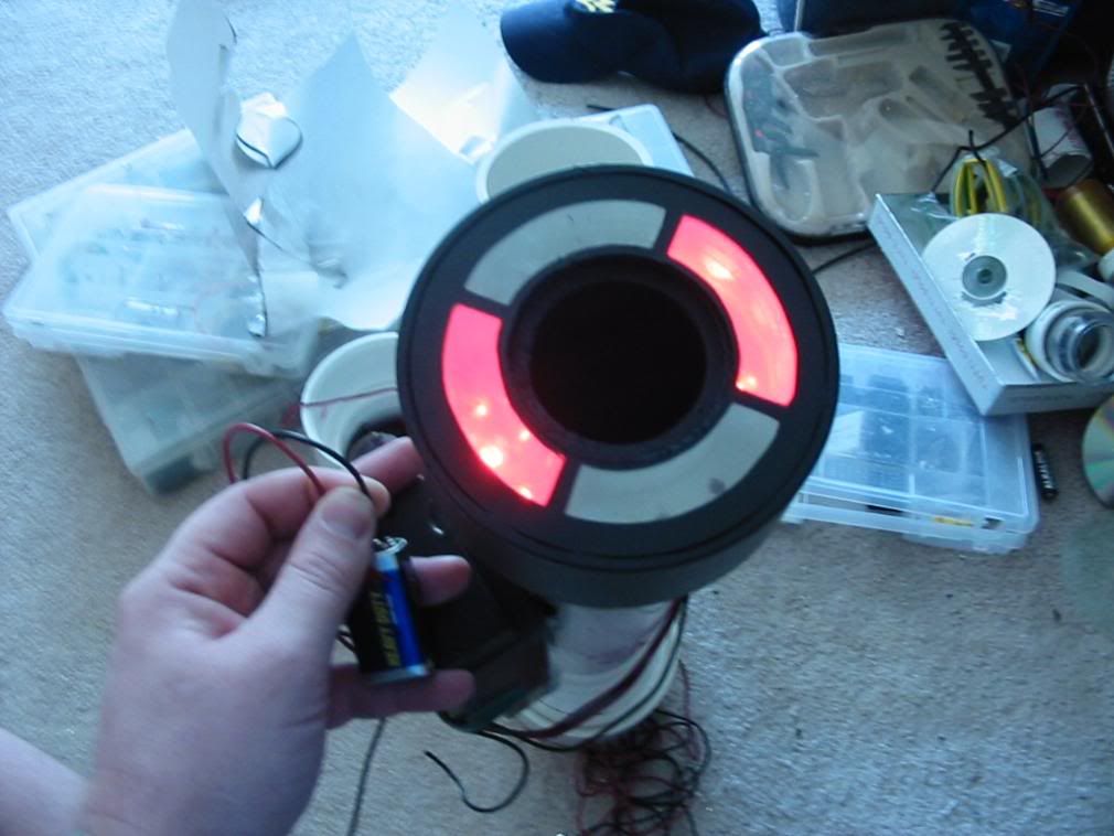

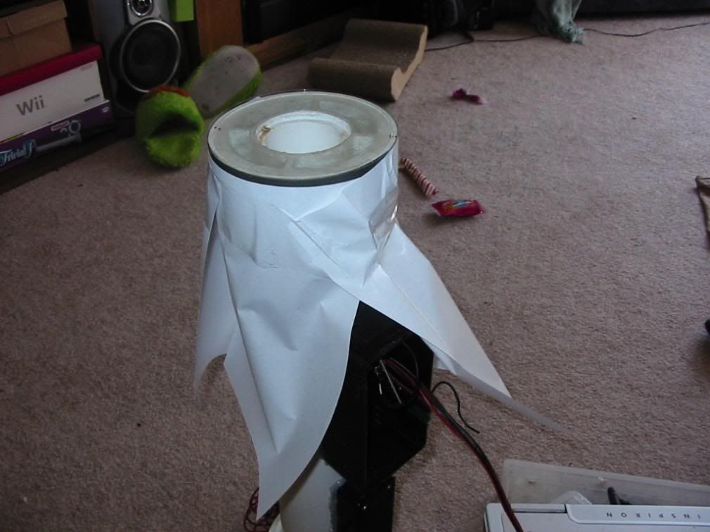

this is the lens for my l.e.d.s so that tater isnt mushed on them while loading the gun.
now i covered it in tape
and cut out the spots i wanted to be clear.. leaving the tape on it. (where i wanted clear)
then i removed the excess tape.. where i wanted it to be black
and sprayed it green
then i wrapped tape around it backwards and stuck paper to it.. to keep the black off the green
now the tape and paper is removed to show my black lense
now this is a MUST.. YOU HAVE TO DO THIS... trim around what you want to be clear again.. to seperate the tape from the paint you just sprayed.. if you do not.. you will peal off the paint when you remove the tape..
starting to take the tape off
got the second piece off with no rips
third off with not rips
4th off with no rips.. Hooray

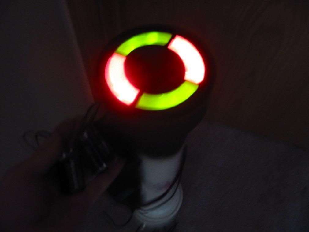

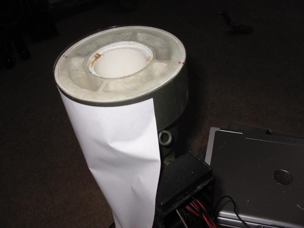

here is what the end of my barrel looks like now
with red l.e.d. on
with green l.e.d. on
with both on
here is what it looks like now.. did you like the lense how to? what do you think?
testing my exhaust fan.. see it running?
anwayss. .what yall think so far?

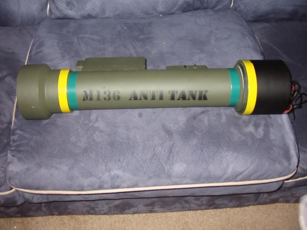

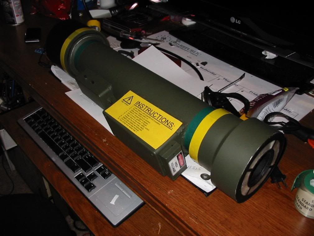

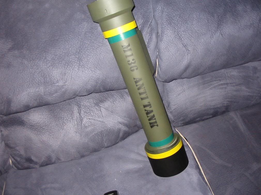

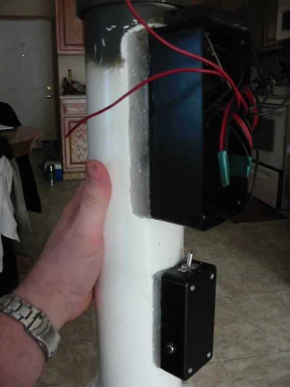

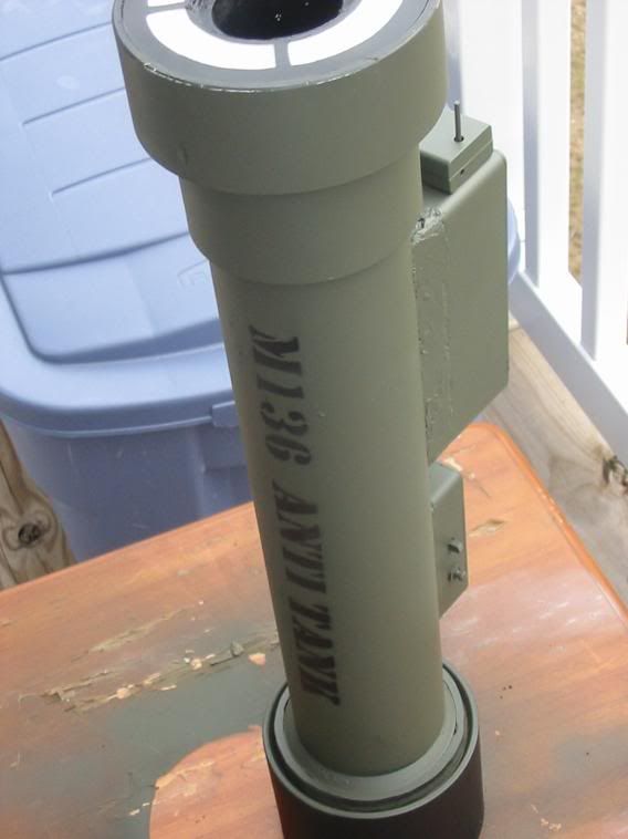

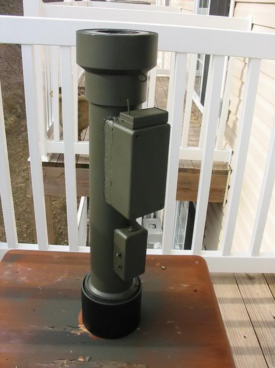

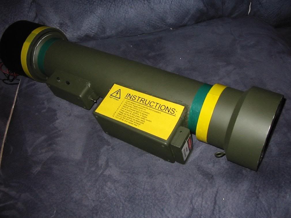

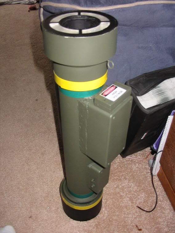

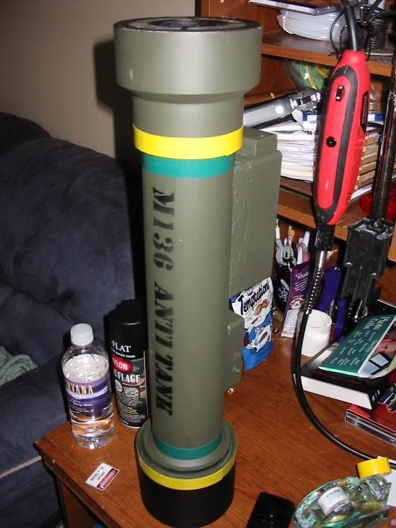

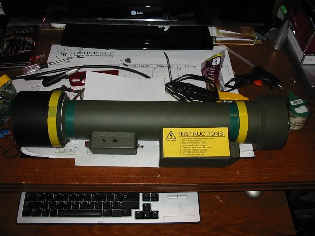

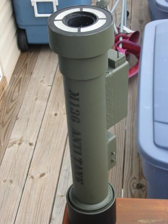

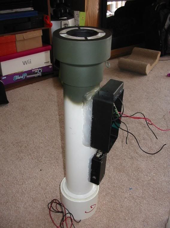

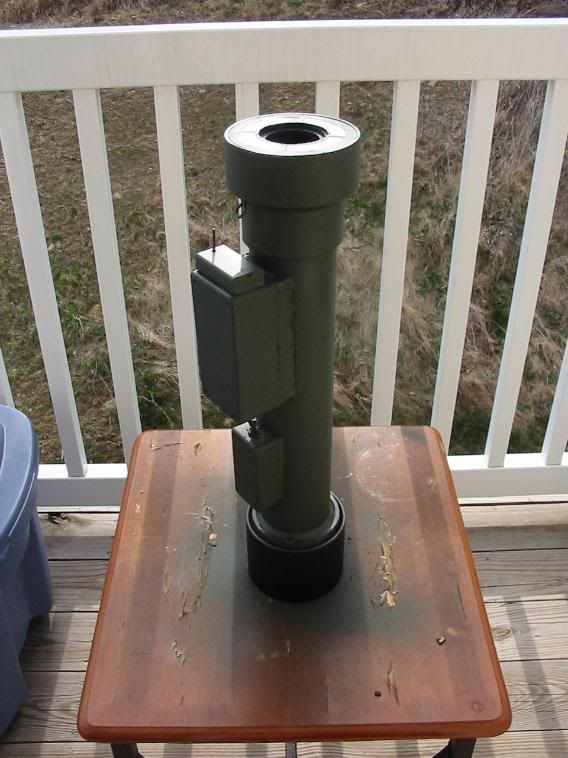

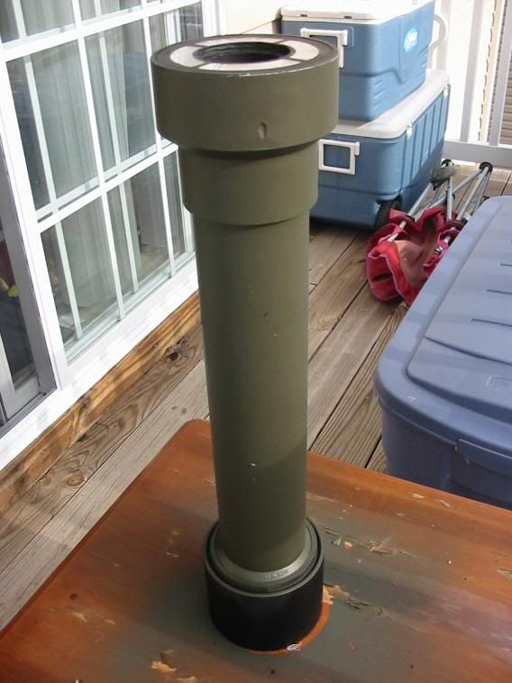

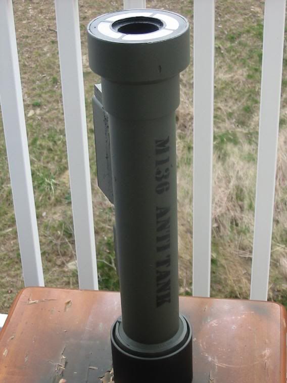

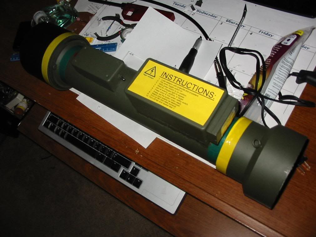

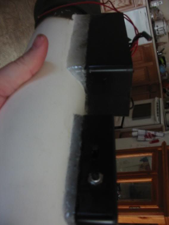

here is an update on the at4.. please leave me feedback on what you think.. weather good or bad.. let me know what you think honestly..

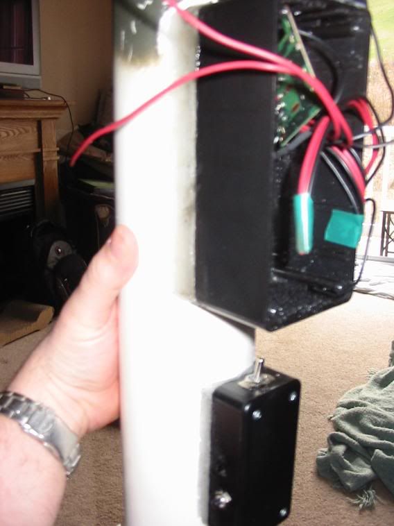

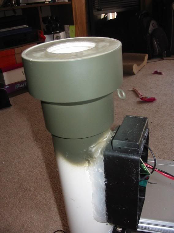

this is the way i mounted my boxes.. to the pvc.. with hot glue.. it melted into the outer barrel really well
here is another view.. not really that horrible
after sanded and shitt you can see how it forms
now to the paint booth.. and the glue will be covered by stickers if you were wondering

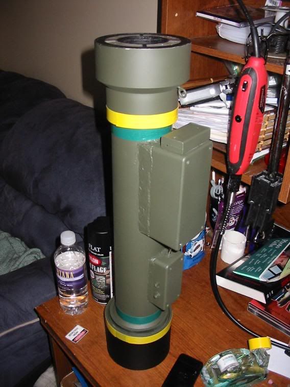

now adding some graphics.. remeber this is only part of the gun.. no chamber has been installed yet
another pic
antoehr pic
adding the base layer of tape.. i will use a real plastic tape later for this on top of these so that it does not bleed through.. but all i had was electric tape now.. and i will use the same color plastic tape later
notice my sticker i made.. high voltage on my double aa batterys
my instruction pic i made
myh girl holding it totally.. the lentgh it wiil be when finished
antoerh pic of it
okay guys.. thats the update.. so what did you think.. of course it will hav emore stickers on it and stuff. but that is all i had done up to this point.. after letting the paint dry and stuff.. so
let me hear your comments.. good or bad.

Daum, that's authentic looking...right down to the warning stickers and such.
Are your instructions from an original AT-4, or are they modified for spudding?
- scottcrete
- Posts: 332
- Joined: Tue Mar 18, 2008 1:26 am
- Location: Bridgeport, West Virginia USA
stickers i made..lol they talk about killing zombies and goblins and such.. lol... they are for spudding... lol..
