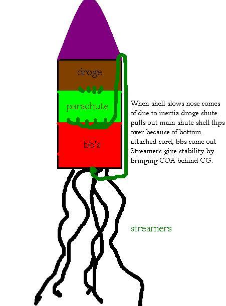

This is probably a better concept downfall small amont of bbs 500-800.

DRoge? what exactly is that?
SO your system relies on the centrifugal force created when the parachute opens on the bottom? Wouldn't inertia and air resistance keep the parachute on the underside?

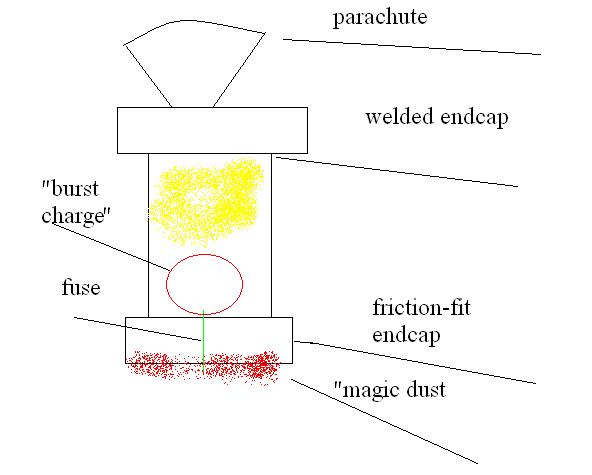

the reason we want artillery in because of that one guy we see and can't do squat about because of a #!$%* little sheet of plywood, we want indirect firepower the same reason they have frag grenades. So to this day we present numerous busting projectile ideas in hopes of a safe simple and practical solution. The concept of antimaterial (not antimatter just stuff like HE or high cal bullets that penetrate the stuff the guy hides behind) is impossible in airsoft because damage to objects most like means potential damage to people, however the concept of indirect firepower is possible and useful in combatmagnum9987 wrote:The problem is, that with airsoft, artillery is not a necessity. You would need scouts to determine the location of the target. And then a sniper could pick the target off, even though not en mass.
i like the idea with the oxy-propane balloon, but i think that it could use some improvement. first, having the fuse lit while loading it seems a little unsafe. i attached a rough diagram detailing my idea. it could be made of whatever material you like. pad it if you want.
i know you are all thinking about using massive pipe, but that will take A LOT of bb's to fill. 3" should be fine...

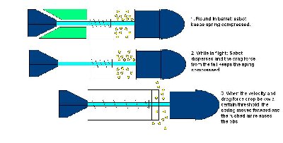

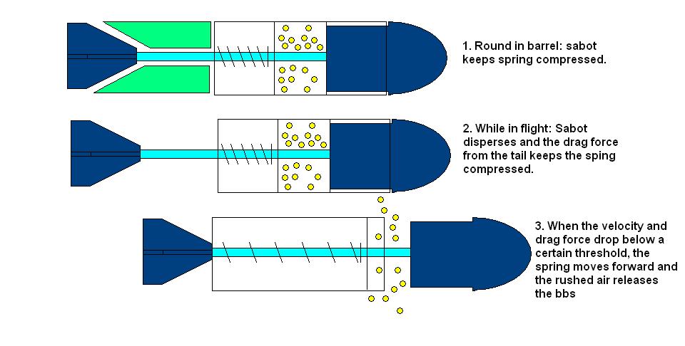

No one? does anyone think this will work. The tail setup and sabot is probably unnecesary. This seems to be the only thing i can think of that does not contain explosives. also, this is garunteed to actuate. It could be made of light materials as well.
