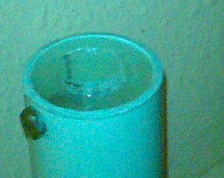

The basic idea, as illustrated in the fuzzy attachment, is simply a cast epoxy plug at the muzzle end that will hold on to the sabot but will allow the projectile/s through. I sealed the cast with candlewax instead of the usual araldite so it should come out pretty easily.
The plug is held by a single bolt to allow for reloading, time will tell if this is sufficient however I'm banking on several factors such as a very lightweight (essentially paper, tissue and duct tape) sabot and the rapid cooling of combustion gasses that will instantly reduce the pressure pushing the sabot against the plug.
If it fails, and likely the point of failure would be a crack where the bolt goes through the barrel, it will simply be a question of chopping off the offending bit of muzzle and figuring out a stronger, multi-point or reinforced attachment. Testing scheduled for 24 hours

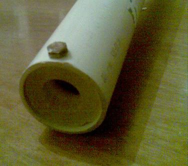

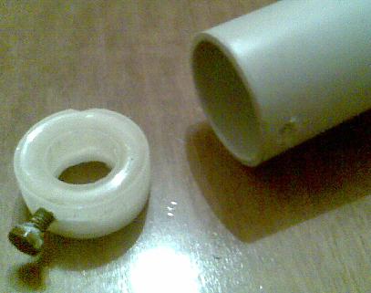

edit: took some photos of the finished plug, installed and removed. It's looking a bit wobbly, I have a bad feeling about this...
We'll find out tomorrow
- Image092.jpg (23.09 KiB) Viewed 3457 times

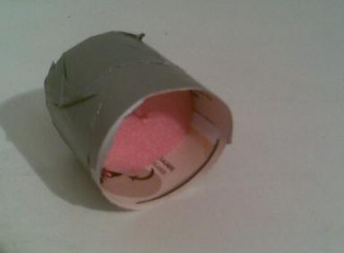

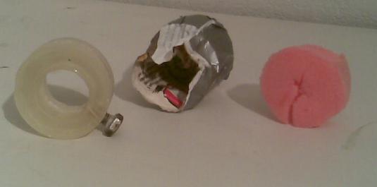

The sabot was a paper-and-duct-tape cup with a foam insert cut from a pool noodle. It doesn't show on the video but the foam actually managed to squeeze its way through the hole in the plug, unlike the paper cup which stayed in the barrel. This would explain the fact that the shot was still pretty loud, though still quieter than usual - note the lack of complaining colleagues in the background
Unfortunately, if you look at the plug, there's a large crack where the bolt sits. I don't think it will take another firing, time to contemplate and make some changes.
- Sabot before firing
- sabotunfired.JPG (8.49 KiB) Viewed 3427 times
- After firing - plug, foam and paper sabot parts
- sabotfired.JPG (12 KiB) Viewed 3427 times
