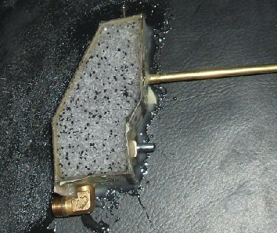

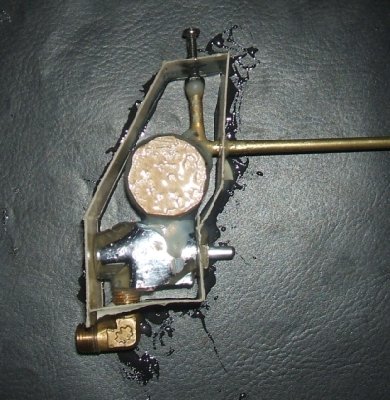

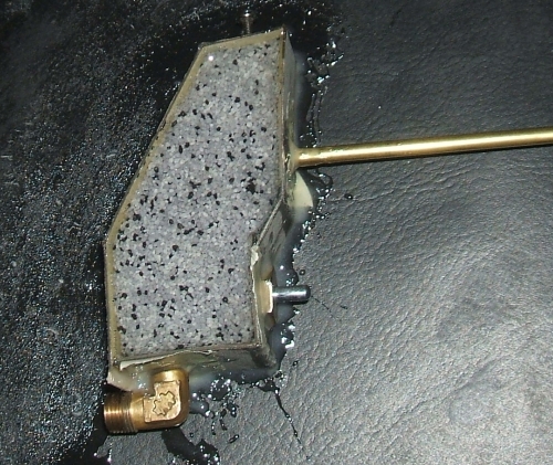

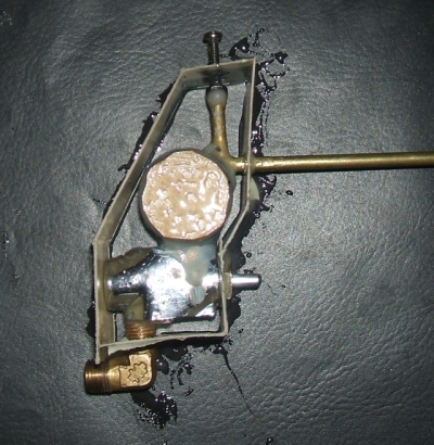

I'm certainly interested in making this in a larger calibre, most probably 0.22". Back to the subject of this thread, in case anyone was wondering what the mould looks like before I pile on the epoxy:

I agree that a separate loading port would have been comfortable, but I don't plan on using this too regularly (3mm hardened chrome steel bearings being at a bit of a premium) so I can live with loading through the barrel. Besides, we're talking less than 150 BBs here.
In any case, too late now... the epoxy filler I'm using is quite interesting, it's an aggregate used in epoxy flooring which I "obtained" - tough stuff and saves you a lot of epoxy :D

it looks like you glued a couple of pipe fittings to a chunk of your kitchen bench lol

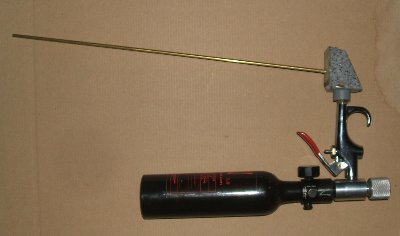

update: bugger, it seems that I chopped the blowgun a bit too close, it's not sealing properly now. Ah well, plan B. I hacked off the BB chamber (going through 3 hacksaw blades in the process, damn tough filler) and epoxied a 1/8" male fitting so I can connect it to an unmodded blowgun, which in turn has a 1/8" male fitting on it so I can connect it to the paintball tank ASA adapter. Did someone say not enough threads :P

Here's what it looks like now, I gave it a quick whirl and the power certainly seems to be there, but certainly not a low rate of fire - as I mentioned, while the detent works chamber size is an issue.
I'll do some proper testing tomorrow after work, I think you can expect some impressive damage videos :)
