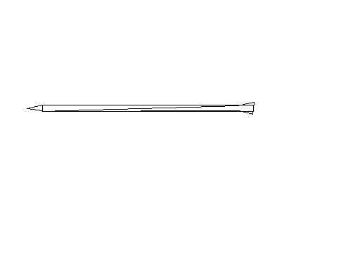

Spin induced by fins hurts velocity, it takes energy to impart spin... Make you're darts from tungstun rod, and then you could braze a tail cone onto it, and you'd have a weiner... infact it could just be brzing filler that makes the tail "wedge"... with a high fps, if the tail diameter is .22 then the main shaft coud be .20 and it would fly straight...
something like this...

Tungsten rod sounds expensive as hell, and hard to machine... I know it would hurt velocity but it is sure to help accuracy is it not?

actually, in the grand scheme of things, go get you some 6d finishing nails, chuck them in the lathe and turn the heads down to whatever calibre you need them, and you'll be surrprised how accurate they are....
