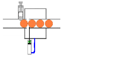

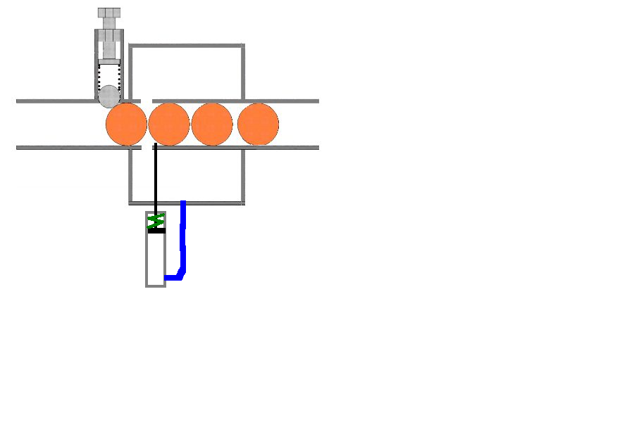

you might add something that would prevent double feds... that's the first thing that came to my mind...
the rod of the air cylinder would keep the second bb from being sucked into the barrel right after the first one fired

is it really that complicated ?? I don't think so all you need is a small air cylinder and a fitting to screw it in...

how about a pop-off like piston that pops out of the way at a certain pressure??
But helas,
I don't wear a cup...
Why the complication when you can have the projectile popping off at a certain pressure? No restrictions, no dead space, no pilot volume, this seems to be the best solution.
Because that calls for a complicated magazine and loading system that is hard to build jam-proof or doublefeed-proof.

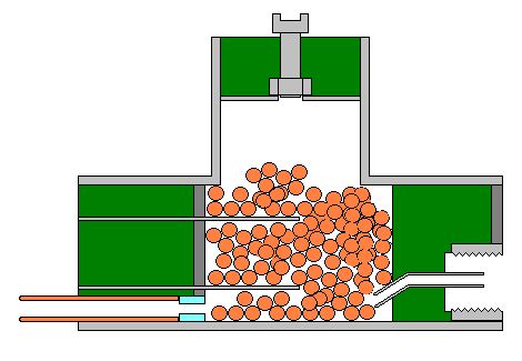

Well, we sure saw what it didjackssmirkingrevenge wrote:we'll see what upping the pressure does tomorrow.
In this regard, my next development is built in a stainless tee which is highly unlikely to fail in the same manner.
The breech is currenly curing, as per the diagram below. There's no mechanical detent as before, just a silicone seal, and in order to avoid jams I've added a "coaxial block" so to speak, together with a suitable angled air inlet to promote agitation. We'll see how well it actually works.
- untitled.jpg (24.94 KiB) Viewed 4730 times
- Posts: 26220
- Been thanked: 352 times
I tried it out earlier hooked up to my compressor, but 110 psi isn't enough to push a BB through the seal. I'm hoping the 20 or so pounds of force on the projectiles provided by the air with the paintball tank at 850 psi will be sufficient to pop it out like a champagne cork
unless it blows up, we'll see
edit: me and my lack of patience, I managed to blow the top out of this one too
Clearly the silicone seal is a bit too much, I think an adjustable ball detent is ultimately a better idea at these pressures. Back to the workbench...
