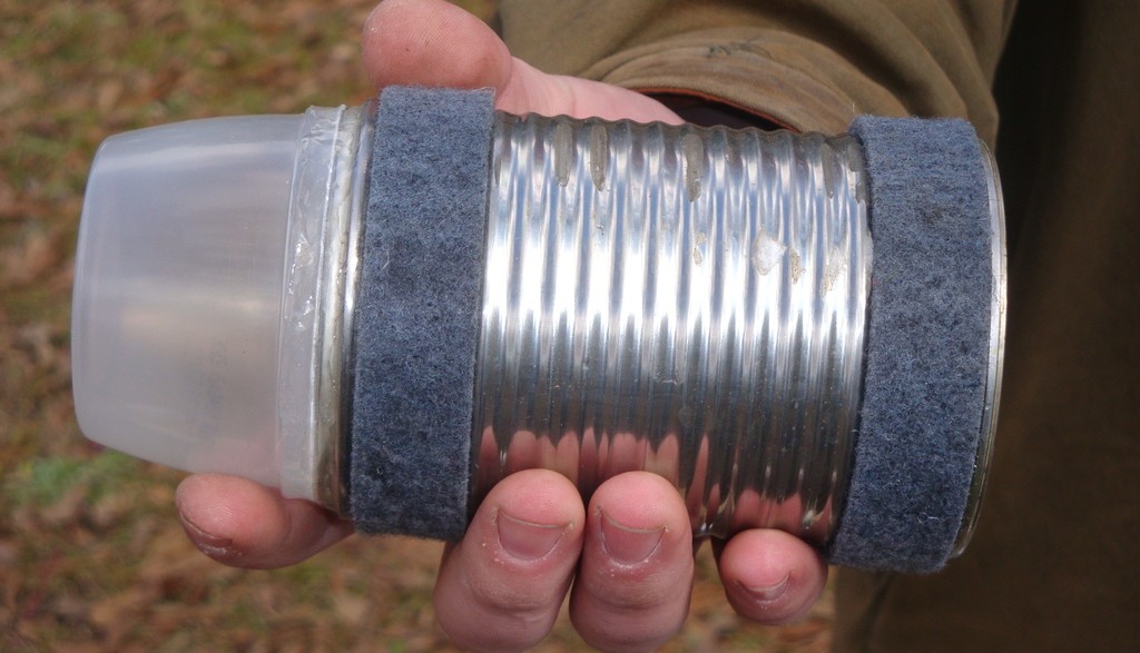

Here's the ammo.  VERY simple design.  The felt is 5/16th of an inch thick and is epoxied to the can.  The "aerodynamic" bullet end is a fruit cup epoxied around the edges .

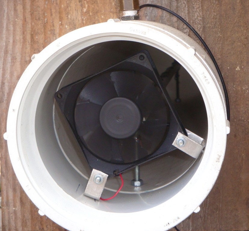

The chamber fan with spark gap farther back in the chamber.  The propane inlet is the brass fitting on top of the chamber.

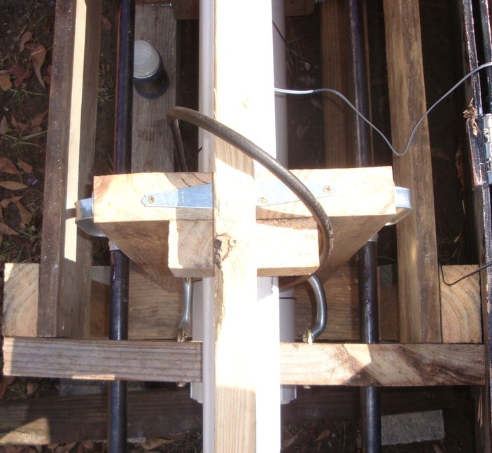

This is our recoil system.  The springs are too long and bent down.  The black rails are what the gun rides on while being shot.

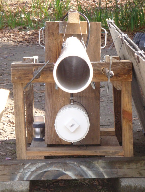

A view from the front.

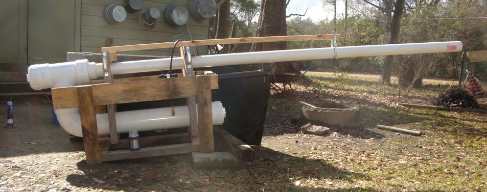

The Howitzer from the left.
