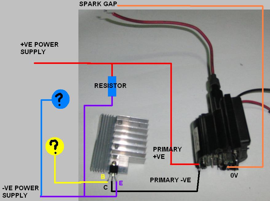

How does this look? I didn't get what terminals represent the "feedback coil" though, are they the black and red wires coming out of the flyback?
I think your question marks hook to each side of the primary coil. According to the schematic I used...
I'm going with this schematic and figured out the pin identities using this advice, from what I can see in the schematic the primary coil hooks up as in my photo diagram, but I have no idea where on the flyback I would find the "feedback coil" outputs.
I have no idea where on the fly back I would find the "feedback coil" outputs.
Continuity tester. There are 3 different coils potted in that fly back.

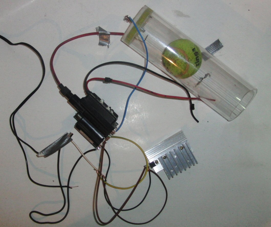

With the lego brick sized 3 watt wirewound resistors - still 220 and 22 ohms it puts off a nice arc from a 12V lead acid.
Again with the dodgy camerawork with the keychain camera but I think I'm getting better at aiming it:
haha win!
Doesn't seem as powerful as Hotwired's (I'm using a 12v 1 amp supply), but looks good enough :) bit late for testing a high mix hybrid but I gave the tennis ball launcher a whirl and it worked beautifully.
Thanks to everyone who put up with my cluelessness :oops:
Here's the setup, twisted wires all the way :roll:

Now that I have it working, I'll probably use JSR soldering (dab of araldite over twisted wires :D) to put it together more permanently, then put it in a container with a 12V CPU fan to keep things cool.
In the meantime, here it is in action as the ignition for the clear tennis ball combustion, *whooph* :D

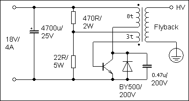

Here's a beefed up version that may help out if your current setup proves ineffective. You can probably fine the 25v capacitor in your junk somewhere. Exact valves aren't critical. The diode should be an ultra-fast recovery type and the 200v capacitor should be a high-quailty foil-film cap(they usually look like plastic boxes).
You may want to buy some transistors eventually, in this case I found a 2n3773 works well.
This circuit upped the voltage of my charger slightly, but kicked out roughly 5 times the current.
edit: here's a nice flyback powered by a MOT :)
