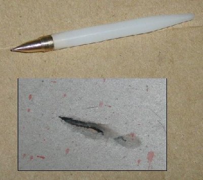

I was thinking about this during my fase REM, that small diameter Delrin taper at the end is going to be a bitçh an interesting challenge to machine...
It might require machining in stages, starting with the tip then moving up.
Or maybe it should not end in such a pointed tip so you can use the tailstock. I'm guessing you're worried about it flexing ?
You could even drill out the centre and put some steel rod in there whilst machining it. Would make it lighter too once removed...
If I start with 12mm rod, make the taper first then turn the cylindrical part down to 6mm it should be fine, working close to the chuck.

Sweet, will you be able to turn the projectiles yourself? The ones I originally posted have endcaps can be made very easily on a lathe and can be popped into suitable lengths of pipe.
Making the tail section out of acetal would ensure it is both light weight and - based on testing I've done - will not burst into flames when exposed to the propelling gasses.
I made a healf-hearted attempt at a projectile that ended up looking a bit Image and is probably the worst thing I have ever machined to do date - still, the proportions were good enough for a quick test, but the results were extremely discouraging.
The inset shows the impact hole in a sheet of cardboard 10 metres away from the muzzle, I shot this out a 300 psi 6mm piston launcher. It was clearly travelling sideways when it hit, this is not looking like it will work.
The CP is to the rear of the CG, but clearly not far back enough to stabilise the projectile.

That isn't going to work.
How on earth did you get the head that bumpy :shock:
How about a carbon fiber tube tail? that should give a better COG

Indifferent use of the compound slide, I made this in a hurry and wasn't really making the effort :)
I want to try a length of aluminium tube as the body then play with endcaps as per the drawings in the first post.

drill out the delrin tail
though to be honest I think you need something even lighter
