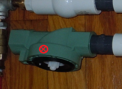

I personally think you should put the sprinkler valve directly behind the piston valve and then tap into the sprinkler valve itself. I have done this many times in different spots. Just be extra careful when you go to drill into it... I went into the seat with a drillbit and now the valve is ruined
But I think it is way stronger and secure if you drill and tap where the red is in the following picture. When I made a cannon exactly like yours for a friend, that is how I did it. It turned out to be a beast. Anyway, if you decide to drill and tap here, be careful because you need to drill in just the right spot or else the fitting you thread in will interfere with the grooves on the diaphragm and it won't be able to go in. When I did it, it interefered a little but it still worked fine. If you don't understand what I mean I can clearify a bit.

Also I got my sprinkler valve back today, and was wondering, I HAVE to fill BOTH holes correct? And did your valve have this plastic piece in it? I read somewhere that if I remove it, then it will make it perform better.
(you have to click the pictures, b/c you can't see the arrows very well)
Holes
This plastic piece
alternative view

A check valve on a piston is useless without O-rings, I wouldn't go to the trouble of doing either your first time around. Get it working, then make modifications to improve the valve.
Fill the solenoid hole (first pic) with epoxy, and IMO you should remove the "plastic thing" it only limits flow. I have always removed them when modding sprinkler valves

There are two holes on the first picture, so i'm assuming I must fill both.
