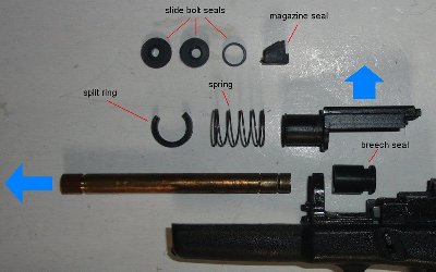

From what I can see that front part holding the spring in place is a plastic ring which explains why mine is gone( broken at some point).
I need that ring.
The Spring.
All the Seals.
But still cant see how that section with the spring/ring/slide release seperates from the frame!!?? as the Slide release buttons will still hold it all in the frame even when that screw under the barrel is removed.
unless I can remove it all I cant install that Plastic Spring Bushing

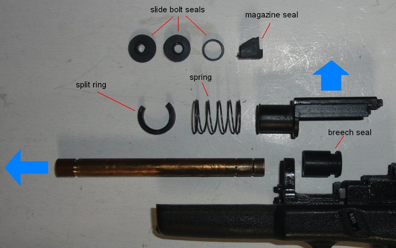

In order to fit the spring, pull the barrel out and lift out the breech piece as per the blue arrows, you can then fit the spring and place the split ring. The seals look like they're in pretty good shape so it should be fine, power should improve and therefore accuracy, though the loose barrel fitting doesn't help with the latter.
I've labelled all the parts I'll be sending, if you need any other part that cannot be identified as part of a pistol then let me know.
Great!, thanks for the info= just worried customs will confiscate the parts when you send them down here and if that happens im screwed as I cant locate spare parts for this anywhere else.
Just thinking that Magazine seal might give away what is is all for?,customs here are very,very smart at knowing what is Airgun/gun parts. Though I will need use another of those seal's at some point down the track I suspect!?.
Im surprised that split ring even holds inplace because the steel part it slides onto only has an extremely small lip on it,or mine does anyway. I tried to pull the barrel out earlier today but it didnt want to come out? so I didnt force it out.

With some careful design and lathework, you can remake the bolt parts in order to accommodate normal o-rings instead of proprietary conical seals, same goes for the breech.django wrote:Great!, thanks for the info= just worried customs will confiscate the parts when you send them down here and if that happens im screwed as I cant locate spare parts for this anywhere else.
If you think it will be a problem I will omit it, besides as it is only under compressive stress if is very unlikely to wear out during the pistol's lifetime, unlike the bolt seals which see a lot of movement.Just thinking that Magazine seal might give away what is is all for?,customs here are very,very smart at knowing what is Airgun/gun parts. Though I will need use another of those seal's at some point down the track I suspect!?.
It's only held by the friction of the breech seal, you should be able to pull the barrel out without breaking anything.Im surprised that split ring even holds inplace because the steel part it slides onto only has an extremely small lip on it,or mine does anyway. I tried to pull the barrel out earlier today but it didnt want to come out? so I didnt force it out.
