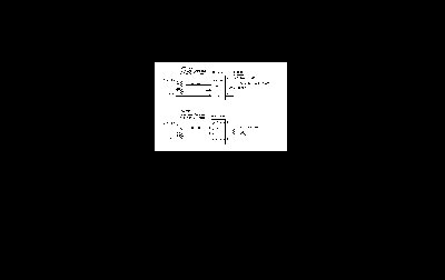

Here is how it should be wired. Basically what Tech said originally.
- Technician1002
- Posts: 5189
Thanks Dewey. I didn't have the resources handy to draw it up. That is exactly right.

Thanks again for the help guys. The diagram is indeed the very first setup I had tried (the diagram I linked on the other page was the second setup I tried) but the reason it didn't work the first time seems to be due to a faulty pot, LED and voltmeter. The pot has a terminal slightly loose so it can either work correctly, not work at all or just provide full brightness. The spare LED that blew seems to have been faulty in the first place as I'm not sure why it blew on this circuit when I first tried it the other day and the voltmeter was giving strange readings on the 10V scale but correct readings on the 50V scale, so I ended up using the divider and working on a 25V scale barely able to see the fluctuations from the pot adjustments.
So it seems to work now that everything's been worked out, I have an even better LED dim range than the circuit I made back in August or whenever. This one only dims the LED to about 50-60% brightness which is the lowest I would ever need it.
Cheers guys.
