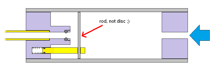

I guess I'm just a fail at sketchupGun Freak wrote:Bends are rather simple to make, and judging by the random circles on the rod I'd say he's new to the program

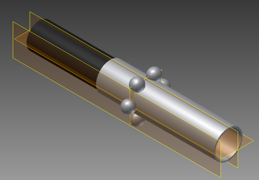

What about something like this? Whipped it up in inventor quick, didn't add any springs or anything, but you should get the idea.. its a variant of a standard hopup detent with 6 detents circular about the tube. The tube the detents are housed in is slightly larger than the BB itself, so as to allow air passage around it to propel the BB ahead of it (to avoid the issue of an o-ring detent). however this does still waste air slightly..
Or what about a standard hopup system(bb slightly projecting into the barrel) immediately before an o-ring detent? I envision this to help avoid the issue of multiple BBs in the barrel and not receiving air..
Thoughts?
Thoughts?
I've pondered this but it's a less-than-elegant solution, unless you can do the math really well.The tube the detents are housed in is slightly larger than the BB itself, so as to allow air passage around it to propel the BB ahead of it (to avoid the issue of an o-ring detent). however this does still waste air slightly...
Ideally, you would have to feed air into the chamber fast enough that time to reach pop-off pressure in the chamber = projectile travel time in the barrel.
I can see it working, but you would need a high flow firing valve and a flow control valve between that and the chamber in order to be able to "tune" it.

It might work, but one thing I like about the proposed blocker system is that it eliminates the guess work because it depends on chamber pressure, therefore:Or what about a standard hopup system(bb slightly projecting into the barrel) immediately before an o-ring detent?
- BB in the detent -> blocker activated, no more BBs can enter the breech
- BB not in detent -> blocker returns to rest, a new BB can enter the breech.
valid points.. i'm just trying to think of ways to get the "perfect seal detent" i.e. o-ring without the problems of blocking off the barrel.. without a complex bolt system like you have designed..

I thought it was fairly simple, but the fact that I haven't built it yet means I'm looking for something even simplerJDP12 wrote:a complex bolt system
Oh it's definitely been simplified down.. but your designs are always a bit complex, and even more so when it comes to testing them... things such as spring pressure, piston area, and clearance issues are a few issues I see with this design. I'm not critiquing your design, just want to try and find something simpler, although I doubt I will.

Homemade hop up incorporated? I did that with an oring and a airsoft barrel. About five minutes later with a hack saw I had an adjustable hop up built into the barrel, and the oring also built up a bit of pressure.
The problem with an o-ring an full auto is that the next bb tends to seal in the o-ring, cutting off air supply to the bb currently in the barrel.

I'm not sure I agree.JDP12 wrote:I feel like this current design you have is simply a more complex design of that, and you could easily modify that for full auto...
Seems like we're trying to reinvent the wheel now.
There detent "valveless" mechanism is hands down the most efficient there is, as I've said many times but I'll list the benefits again:
- zero "valve opening time"
- 100% full flow at projectile motion
- zero dead space
Any type of blow forward mechanism will by definition be less efficient, and need more air at higher pressure to get equivalent power.
The only problem with the detent is reliable and sequential feeding, and I believe this is a simple way to solve the problem.
Shaved the design down a little in the meantime, I think I can give this a go this evening pending some dramatic epiphany
- detentblockermod.PNG (9.03 KiB) Viewed 26688 times

It would not lose air in the sense that there wasn't an exhaust valve (same as my pop-off design really) but you still lose air with whatever bolt mechanism you choose to make.

Oh.. doh. I'm an idiot. *Wanders off to wonder if engineering is really the degree for him*
Well now that I figured it out, I definitely like that design and think it would work very well, can't wait to see results..
If I may make one suggestion, make the back part of the spring/plug housing removable so you can swap out springs. Since you may not get it right the first time, saves you from having to build a whole new assembly.
- Posts: 26220
- Been thanked: 352 times
I'm sure it isJDP12 wrote:Oh.. doh. I'm an idiot. *Wanders off to wonder if engineering is really the degree for him*
Yup, the back plug will be removable. I need to reload it somehow anywayIf I may make one suggestion, make the back part of the spring/plug housing removable so you can swap out springs. Since you may not get it right the first time, saves you from having to build a whole new assembly.
