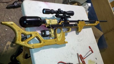

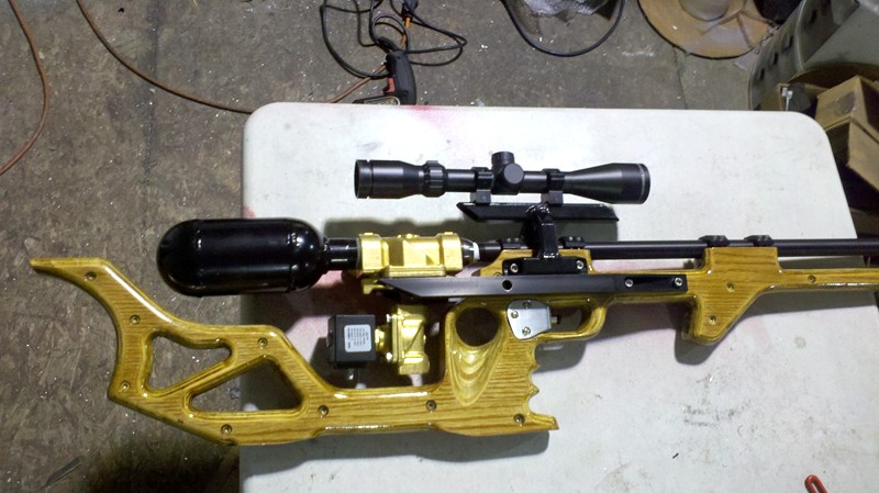

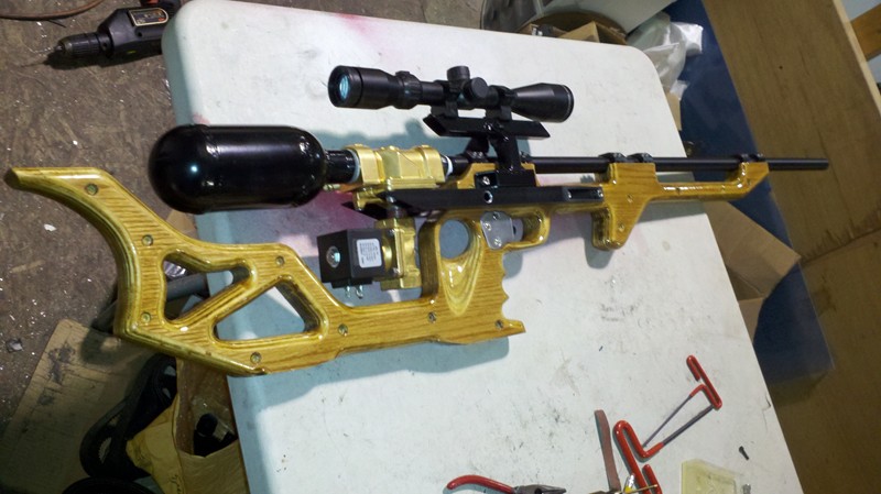

Done.........
Exotic E-bike builder, air cannon builder, and overall crack-pot. ;~)
Done.........
MUST.... NOT..... FAP!!
Damn it's awesome - I even zoomed in to see if it isn't photoshopped or something - looks too good to be true
al-xg
Great Britain
Posts: 643
That is indeed very nice.
Fnord
Posts: 2239
Location: Pripyat
:shock:
I think you just steampunked a starwars rifle...
High-PSI
Posts: 231
Joined: Sat Oct 09, 2010 7:43 pm
Location: Nothern Illinois
I have one last thing to correct;
I have to charge the gun inverted to get the diaphragm to seal. So, I need to install a light spring above the diaphragm to push it shut.
I was ready for this, though. When I built the gun, I figured this valve would struggle to seal when sitting inverted like it is.
No biggie, though. :)
Matt
warhead052
Posts: 1769
Holy shit, that's nice! I want one!!!
With the pressure you are using, it doesn't matter if the spring is super light I wouldn't think.
Holy mother of fap. You know you've built a beautiful launcher when no one asks for damage pics :D
I love the way the obvious and exposed off-the-shelf parts in no way detract from its aesthetic appeal, amazing job!
HunterT
Posts: 113
Joined: Wed Jul 07, 2010 9:46 pm
Location: Just east of Russia
[In a Scottish Accent] It's a real beaut'!
Excellent work!
pneumaticcannons
Posts: 392
Weere teh damage pics??? :D
Amazing job! I really love the trigger!
High-PSI
Posts: 231
I fired it in the shop at 350 psi and it penetrated two 1/16 inch sheets of aluminum with a steel ball. I am downright afraid to fire it inside at full pressure because this thing is approaching firearm muzzle velocity, though I have dry-fired it at 600 psi as a test. I need to get out to the range to really test it. I also need to dial in the scope. I have a sinking feeling my scope mount may not be extremely straight. It may take some time to really get it dialed.
I think the only real issue will be the fact that it is a single shot muzzle-loader. I think I will get a longer feed line so I can leave it connected to the compressor for easier refills. That way all I need to do is reload and hit a button to recharge the tank without coupling and decoupling for every shot.
As for the trigger, I have so much time in this gun, I really needed to find a trigger that did not require a bunch of custom machining. I am actually shocked how natural and comfortable that simple button is to use. Also, the mounting bracket is recessed into the wood so it does not bother your palm in use.
