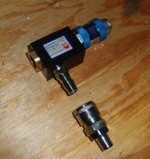

BSP or NPT?Crna Legija wrote:Goats spudz wrote:Hey jsr on your popoff and slide-check are they 1/4" bsp?id say sojackssmirkingrevenge wrote: the thread is a 1/4"pipe thread.
qev and slide valve semi auto?

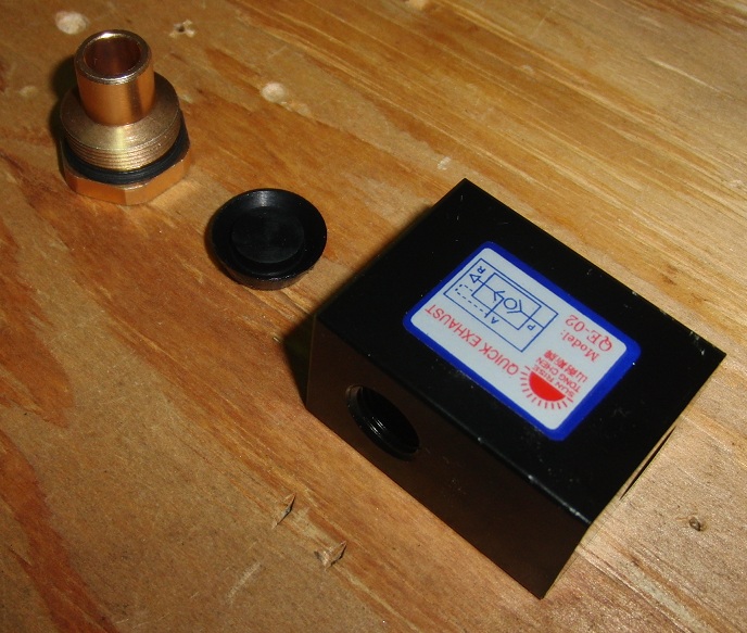

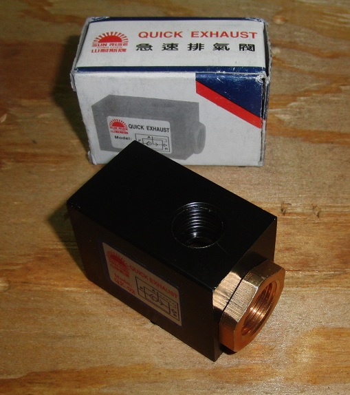

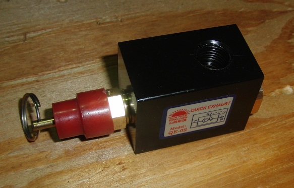

My fittings are BSP, can't say how it fits with NPT.Goats spudz wrote:BSP or NPT?
QEV arrived today, very smart and chamber/pilot threads are perfectly compatible with the other fittings I've bought, which makes them 1/4" BSP.
The "barrel" end as far as I can tell is 3/8" BSP.
I'm going to make a small chamber and have some fun with these parts, if all goes well I'll do a little Volkshalbautomatische write-up

Jack, if you don't mind my asking, can you measure the dimensions of the qev? Like the width, height, and length?
Aren't they allwyz2285 wrote:that qev looks really simple
It's all in the specs:can you measure the dimensions of the qev? Like the width, height, and length?
Product Name: Quick Exhaust Valve
Model: QE-02
Gold Tone Port Diameter: 16mm/ 5/8"
Inlet/ Outlet Ports Diameter: 12.5mm/ 1/2"
Flow Medium: Air
Operating Pressure: 0-0.8 kgf/cm<sup>2</sup>
Working Temperature: 0 - 60°C
Total Size: 52 x 36 x 28mm/ 2" x 1.4" x 1.1" (L*W*T)
Main Material: Aluminum Alloy
Color: Black & Gold Tone
Net Weight: 105g
