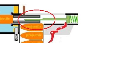

- Brian the brain
- Posts: 3497
- Location: Holland
- Been thanked: 7 times
But if the bolt leaks you will get some loss.
So...
How about this idea:
Use the firingpin as the safety.
In cocked position it should leak, when released it should be as airtight as possible.
You could do this by having it all fit REALLY snug to avoid unnessecary losses ...then file the portion that travels in the bolt down so when cocked there is an open airchannel.
This could be done without any other changes.
So...

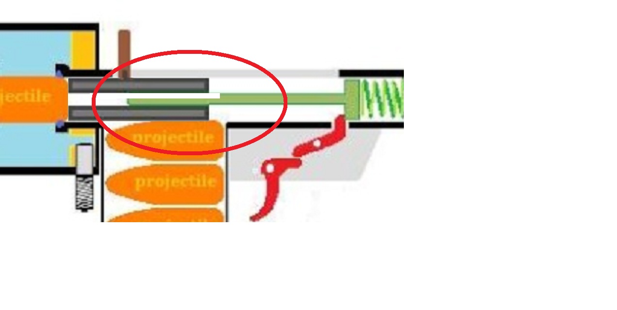

- Brian the brain
- Posts: 3497
- Location: Holland
projectiles=good
launcher= very good!
For safety reasons with 100% seal : change the bolt.
Cut out a section, see picture.
Maybe ask Al-xg for translation.
