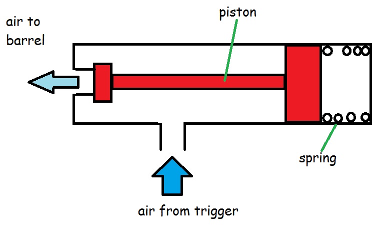

A extension to move back the sealing face it's a good idea, the piston can be simpler and consequently lighter- faster opening and more power. But either way, without a chronograph I don't think the power will vary noticeably (JSR may say otherwise, I'm just too lazy to think about this matter thoughtfully

Why not an off-the-shelf QEV and pop-off?
Wait, are you planning something like this?
Never had much luck with this configuration, they all cycled way too fast to be useful.
I figured if I made my own, I could increase the volume of the chamber?
I figure a small chamber hidden in the pistol grip would suffice.
Yeah, it would sure save me a lot of work...
