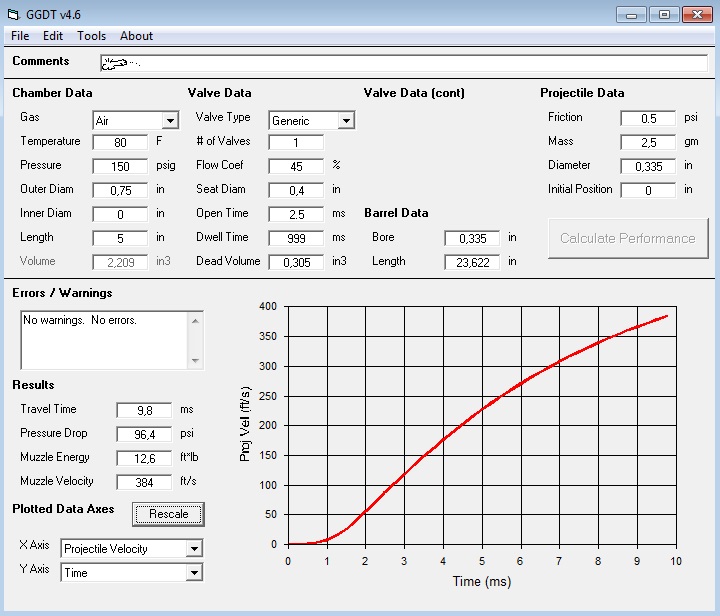

I saw a thread about asking if someone can run your figures through the program (can't for life of me remember its name) can someone either post me in the direction of this thread as I wish to follow any necessary protocol,, or if its just a case of asking nicely would anyone be able to run my figures as I had no access to a PC at the moment.

Using a QEV and a slide valve to control air flow, I will have a main air storage tank of ~900-1000ml and then a secondary tank which will be the air for each shot, just need to know what the ideal should be?
Due to my intended magazine and loading system the barrel my be just under 24", maybe 23" where the ball bearing will enter, but I guess as the QEV is at the end of the barrel it doesn't have any effect? Or does it?
I am a newbe, but keen to learn and understand, I don't want people to think I am wanting them to do everything for me, just stuck without a PC to run the program, I am interested in ultimate power that I can get from my setup. Screwed up on my barrel size really as no cheap slingshot bearings come in this size, so once I have an up and working gun I may alter this so ammo will be cheaper.
With only 150psi and a 12mm (~1/2 inch just under) will the heavy ball bearing ammo exit so slowly and virtually just drop out the sky after a few meters/yards?

Here's a quick GGDT model:
With a firing chamber volume of just 35mL at 150 psi, you get 384 fps for a 2.5 gram ball bearing and are just above the UK legal limit. I also threm in a generous 5mL of "dead volume" - space between the QEV and the BB - to account for your reloading mechanism.
Most certainly not. A typical CO2 pistol will shoot steel BBs around the same speed and has a fairly decent reach, while here you are shooting a projectile that is over 6 times heavier.With only 150psi and a 12mm (~1/2 inch just under) will the heavy ball bearing ammo exit so slowly and virtually just drop out the sky after a few meters/yards?

Are you saying i will only get around 12lb/ft from my cannon, I am am very disappointed
I could buy an air gun with that much power. What is the problem with my design? Do I need more pressure or heavier ammo? As a lot of peoples on here seem a lot more powerful?
Is the 35ml secondary chamber optimal for power or is that to keep it down to the legal limit?
Looking at your first simulation with the program you used an air volume of 10, so if I make my chamber 10 and replace the barrel with 1/2" that will get my power up, Some and then for any more power I'm need more pressure correct? Or have I got it all confused?
It is looking like I need a shock pump short term until I am able to source/setup a fridge compressor. I think I will increase my pressure, check the cannon is all fine using my 8.5mm ammo and the source a new barrel/ammo to get some proper power

PS Worried I am going to be disappointed with the 8.5mm BBs so have ordered some 12mm BBs with the intention of measuring them and then purchasing a barrel(tube) for a nice fit.
