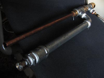

I have completely fixed all the leaks but I can't fire it off at more than 50psi because I can't push the one way valve open. A hammer is the next thing to get. Thanks for the idea of using the small pressure gauge, I will use that.

- This pic is a bit hard to see but I made improvements. Small pressure gauge on the front now.
- rencarnation.jpg (11.7 KiB) Viewed 4587 times

I use a soda stream regulator.I like the look of a paintballtank and PB reg better but hey.
And you shouldn't call it a replica.
It has evolved beyond that.It's different( I won't say it's better yet!!).Too bad you can't open the pilot valve that easy.
It will need a REALLY heavy hammer from what I can tell.

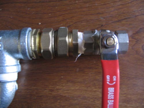

Ok, I got rid of the one way valve because you needed too much force to open it. It works fine for sprinkler valves but not as main exhaust valves. The only other think I can think of is a ball valve but when I was testing it I found that you need to open it very quickly to get the piston to work.
I came to a conclusion that the more space after your piston, the bigger and faster exhaust valve you need. Therefor I need to get the least space possible behind my piston. I will have to see what happens if I put the ball valve directly after the piston housing but then I will have to put the filling tee and another ball valve after that.
Using a ball valve to fire it off is very loud. I suggest using a spring loaded design for ball valve. Example: with your hammer design, instead of the hammer having a point of rotation on a skrew it can be connected to the ball valve handle (handle removed, connected on the actual threads). Then a trigger like that of yours will lock the 'hammer' when it is cocked. When you pull the trigger the ball valve will be shot open.
What is your opinion?

If you use a spring you should be able to fill from the chamber side.
I used a ballvalve that has 2 extra 1/4" ports.
That was very expensive.A little spring would solve your problem.
I did the same thing.Screw on the schrader part, fill, close valve, and remove the schrader( in a pipe with endcap)
