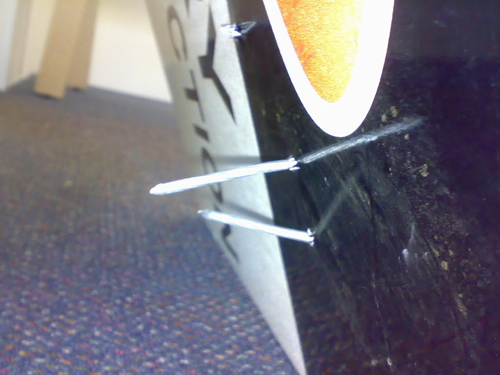

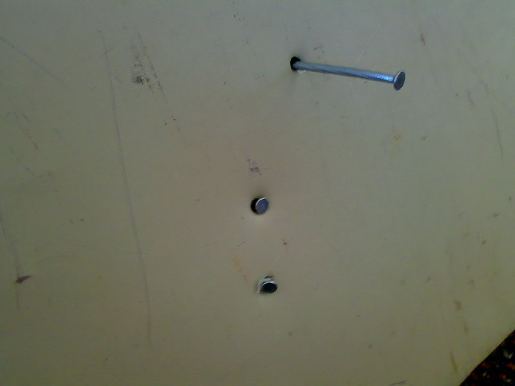

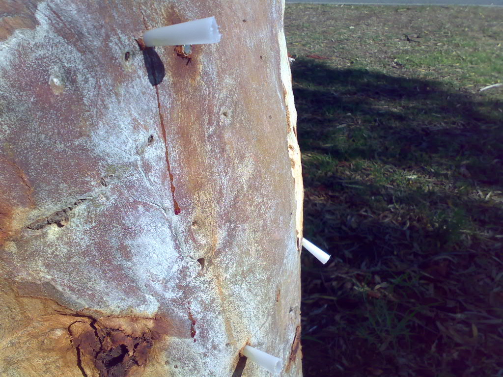

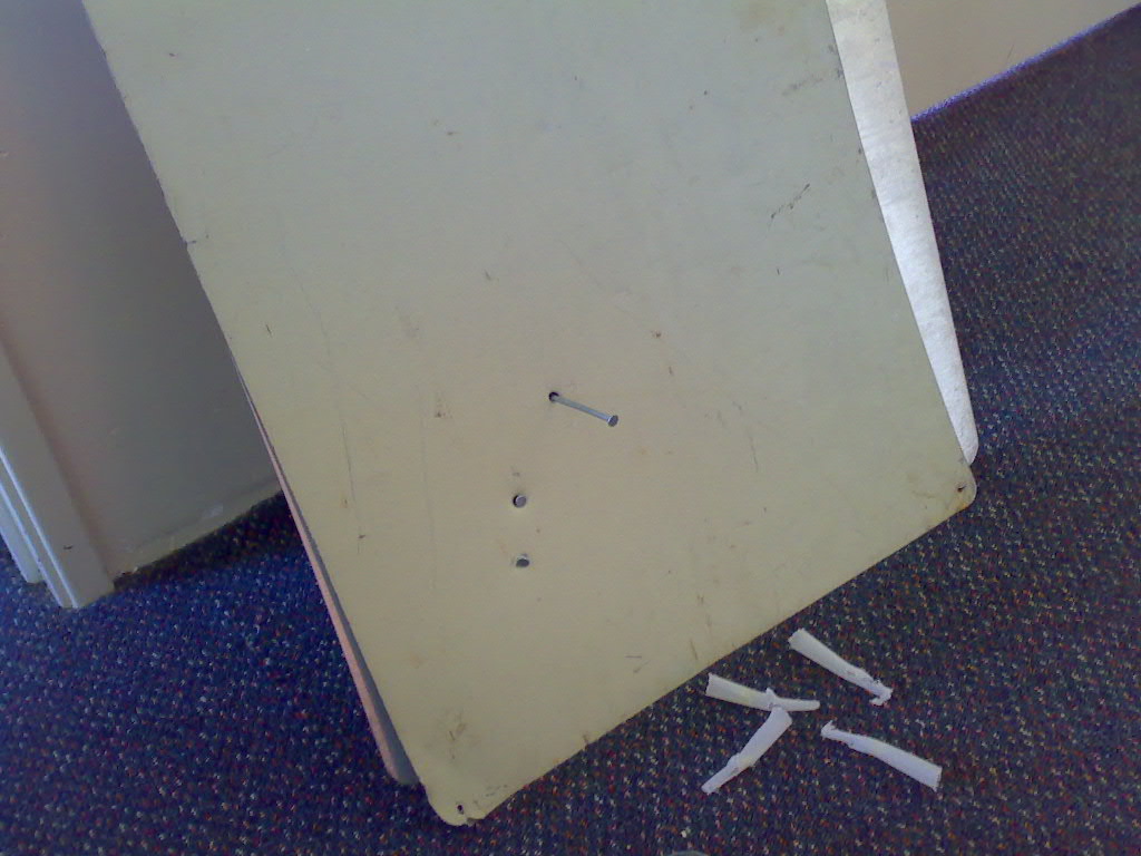

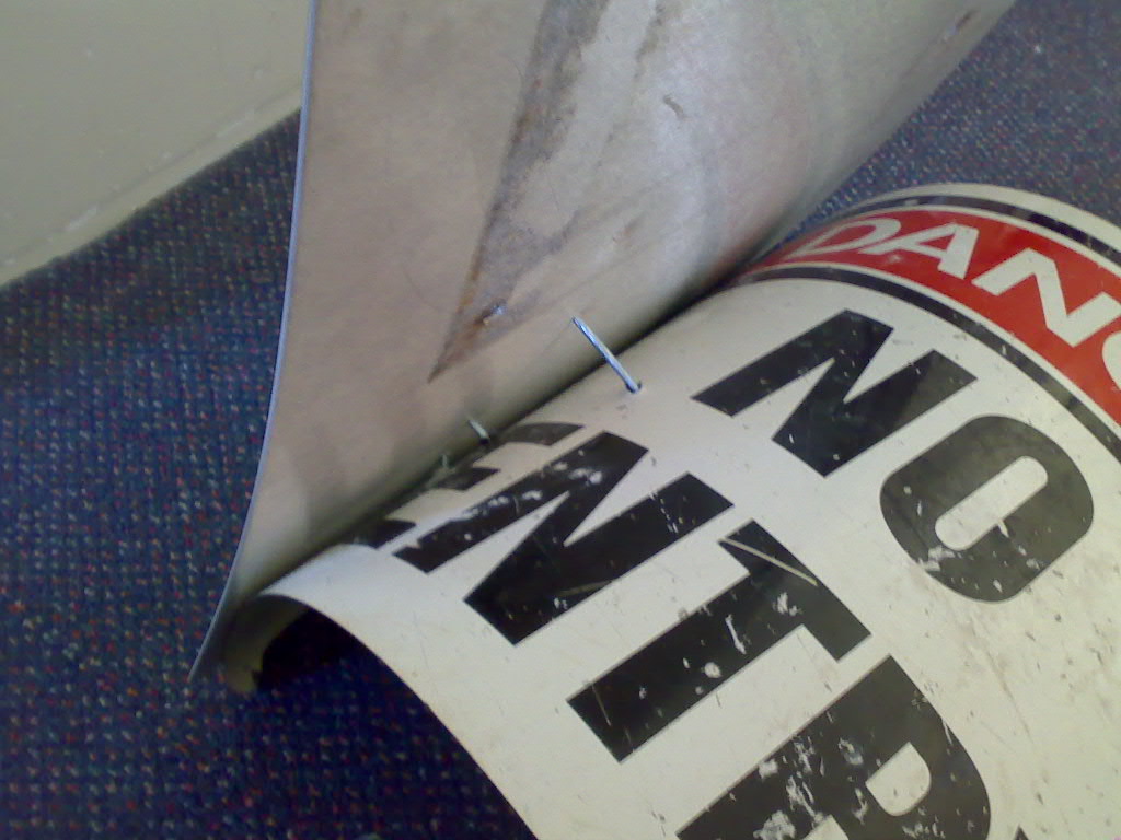

Just thought id finally add a few pictures of what the nail darts look like after penetration.
The first lot are of the darts in a tree i fire at from about 45m away. As you can see, they TOTALLY embed themselves, and we are talking 3 and a half inches here folks into the rather tough exterior of this old eucalyptus.
The second set of pictures are a couple i fired this morning into two aluminium signs i "found" around the neighbourhood. They all went through totally, only stopped by the head of the nail. The plastic stabilisers were sheared off by the force of the nail embedding itself. The nail sticking out was the first i fired, its only like that because at first the two signs were some distance apart, with the smaller one at the back, but i changed the config after that one.
anyways enjoy! tell me what you think hey?
