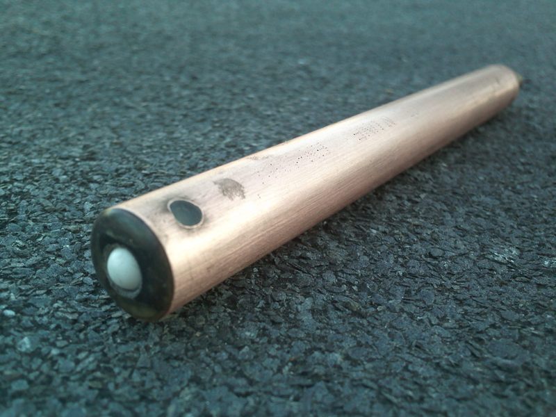

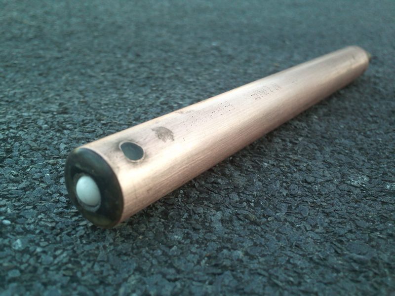

I tested my at 10x mix, everything worked perfectly :D

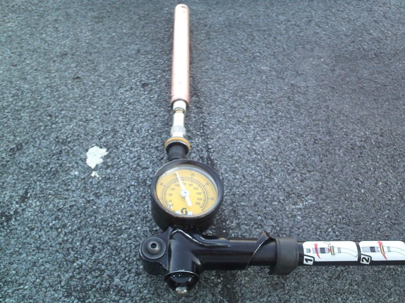

charged to 15x(only air), the valve still holds the bb, no leaks :P
10x with the bb in place
15x
15x
Good on you :) remember you're messing with very high pressures now, be careful!

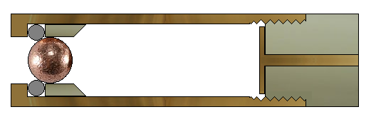

here's my 5c...
Why not ditch the combustion compressed O-ring, and use a piece of threaded Delrin to compress it?
(too lazy to use autocad)
When loading you loosen the ring, and after loading you compress it and fill it with mix.

Labtecpower wrote:Why not ditch the combustion compressed O-ring, and use a piece of threaded Delrin to compress it?
Similar to this, hmmm...
But I see you had sealing problems..
In the drawing the edges are straight, but maybe you could get a better seal if you put a very light edge on it (pushing the O-ring inwards)
