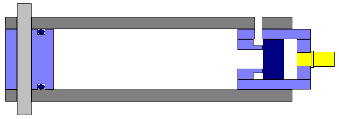

al-xg wrote:The Delrin would still have to withstand the 28x starting pressure.
Maybe I can cup it, as attached?
Threaded Delrin just doesn't seem right :D Although an added 50% thread length would look safer somehow.
I know what you mean, but it's such a small bore...
It seems the reduced ring surface aera works quite well. With the last drawing you could do the smaller "O" ring with a stepped bore to prevent too much compression, would be nice if it worked without though.
Hmmm... interesting thought.

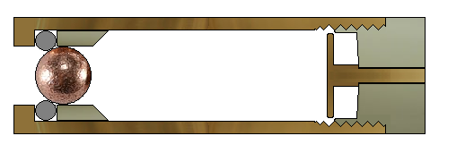

Oh, I meant to post this the other day, but was at work and forgot.
Part sizes are a bit random (fat o-ring :D), the bore is .22 though.
Oh and that front section is meant to be threaded, not sure what I did there.
Edit: Oh and I meant to make the O-ring compression stop a bit longer.
Also Edit: I meant to drill a couple of holes in the srew in brass bit, to be able to unscrew it, with a handy custom tool ?
Looks great but unless you use thread tape... or have I missed something?
al-xg
Great Britain
Posts: 643
Yeah no tape would be better. Tapered thread? Or O-ring on the brass or Delrin ring. The delrin plug should seal depending on the fit but I guess an o-ring or rubber washer could be used.
...or just drop the compression stop and use a closer to bore size cartridge like the last prototype.

al-xg wrote:Yeah no tape would be better. Tapered thread? Or O-ring on the brass or Delrin ring. The delrin plug should seal depending on the fit but I guess an o-ring or rubber washer could be used.
A groove in the delrin ring should allow it to act like a parachute seal.

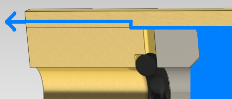

Oh and while I'm at work...
Some more useless 3D. I just like using the program :)
Obviously the O-ring wouldn't be used with the cup. (that sounds worse than I thought)

Could one not just chuck a spring in there?
to keep the ammo pressed against the oring ??
hmm you might be right

Between the ring and the check valve, coil diameter close to the cartridge ID. Fair point with keeping the projectie in place though, I guess one just has to keep the cartridge pointing down while filling.
