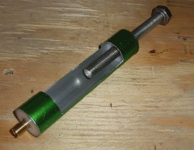

At this point, it seems quite silly not to - but the advantages of a "valveless" cartridge mean it's worth some effort.Also why dont you just use a burst disk?!
Tried that too, sadly the skirt is too soft to hold decent pressure.Also for pellets you could do this... (Push the skirts so there larger like many spuders do so they can use them in 6mm id barrels.

This looks much easier than the previous one!
Do you use delrin for the plugs?
Yep, all put together with araldite. Also I cut the slot out of the tube using the mill and slitting saw, nice and neatLabtecpower wrote:Do you use delrin for the plugs?

One thing I don't like about it is that mix number is limited by the capacity of the cartridge. Pump dead volume is 1.75mL, which means that say the cartridge volume is 1mL, if I flood the cartridge with butane that's 1mL out of 2.57mL which is 36%, so the maximum mix I can get is 11. To solve this I could either try injecting fuel into the pump itself instead, or customising the pump to remove the dead volume.I like it

I like it - simple yet it does its jobA different take on the fill rig
... aaaand win!

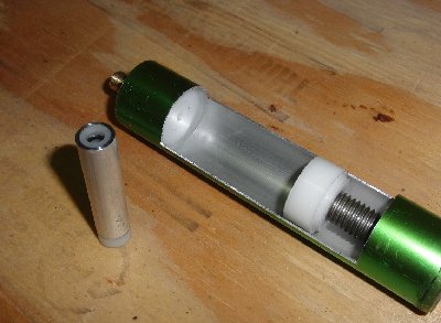

Tried out with a 0.177" cartridge I had made a while ago but hadn't worked with my other fill rig, the above is at 6x.
I didn't need to use a rubber seal, the smooth face of the cartridge mated well with the delrin endcap:

How's the power for that cartridge? What mix can it take?
I love lamp
With the o-ring set as it is on this particular cartridge, beyond 90 psi or so it will eventually let the BB pop.Lockednloaded wrote:How's the power for that cartridge? What mix can it take?
In any case, I'm not expecting power to be amazing. At 28x my 0.177" mini was about as powerful as an adult air rifle. For this reason I'll probably move up to 0.22".
