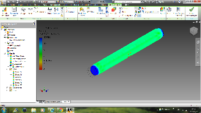

I was simulating using Autodesk Inventor Professional (student version) a chamber for my pcp, but I think I have done something wrong
Material: stainless steel, 440C
length: 10 inch
OD: 1 inch
Wall: 1 inch
Pressure: 3750psi (250bar)
It shows a minim safety factor of about 2, but I can see the chamber gets deformed quite noticeably
I´m pretty sure that I did something stupid
I´m studing how to use Autodesk Simulation Multiphysics, but haven´t be able to use it effectivelly yet.

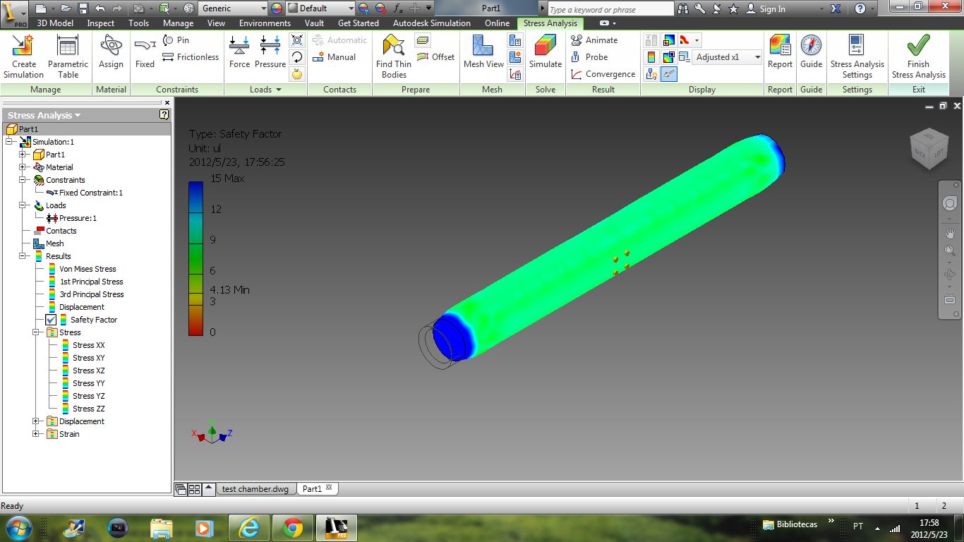

A picture of what I´m trying to do. The model it´s just a cylinder, I made it just to see how the simulation works. I can create parts far better than that
length: 10 inch
OD: 1 inch
Wall: 1 inch
- POLAND_SPUD
- Posts: 5402
uhmm IIRC that's perfectly normal - the program presents them in this blown out of proportion way so that they are easier to notice

Ah that makes sense, because when I did the same simulation in multiphysics, nothing happened. Well anyway safety factor (in yield strength) 2 isn't safe enough but 0.15 inch wall thickness brings the minimum safety factor to around 4, so I'm pretty sure about the chamber size/material now.

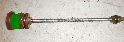

but would making a epoxy cylinder to make the rod the dia of the piston reducing the back of the sealing face surface area for pressure to push agianst?.

dam really don't wanna reduce the seat dia, because i want it to be decent with golf ball as well as smaller ammo too, right now HGDT is saying 110ms with a golf ball at 10x disk bursting at 1000psi.
