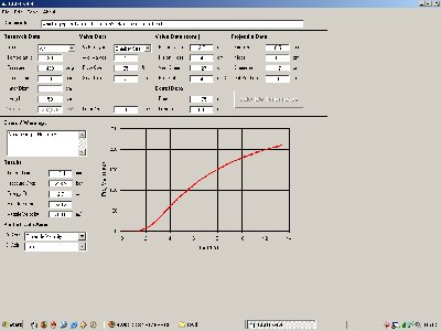

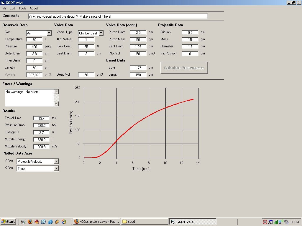

could someone please GGDT this gun for me because i can't get it for various reasons.
28mm x 50cm chamber
25mm piston with a 20mm porting piloted by a 1/2" qev
20mm x 1.5m barrel (17.5mm id)
operating pressure 400psi
ammo 0.68 paintball (17.27mm i think)
anything i have missed?
thanks Alasdair

well Al-XG gave some specs and it doesn't have to be spot on.DYI wrote:There is copper tubing, but no copper pipes.

thanks, they were the kind of performance figures i was hoping to see
i think paintballs are 3-4g
and i might just have to make myself some 15g ammo because 330j is one hell of alot of power
edit: could you also model it with a lighter piston because i'm using hdpe which is ~0.94/cm3 so i would need a 50cm3 piston to do that which would be more than 10cm long
so a 5cm piston would be 23g
and the valve is a barrel not chamber sealer thanks Alasdair
