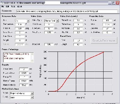

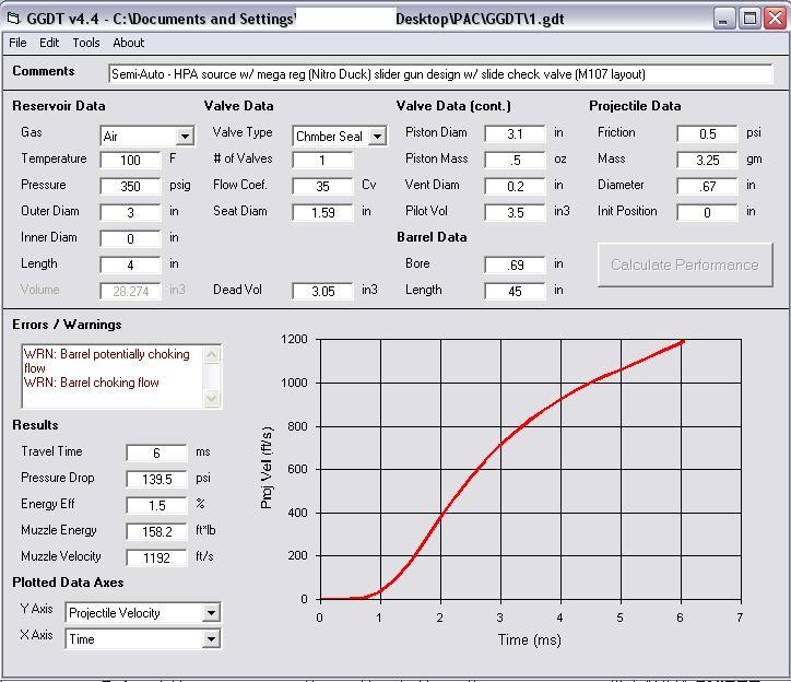

Yeah heres a link the valve http://www.sakworldpaintball.com/slidchecval.html I opted for a paintball valve over a normal slide valve as the cannon will be operating at around 250-300psi. They are fairly small ports - 1/8 normally I think. I was thinking either that or I could machine one out of alloy. That would mean the o-rings would have to be really thick and tightthats all. You think it would be worthwhile making one or using one of the smaller paintball ones?

You dont need thick o-rings. all you need is the right groove dimentions for the ring you are using. The groove needs to be 90% of the O-ring thickness and 100% of the ring wide. these can hold 100's if not 1000's of psi.

Thanks spud, so the groove width is horizontal in reference to the valve being horizontal? Yeah clide I'll put in a ggdt pic that shows the stats. I was planning on running the slide valve to a remote trigger using a brake line (wire) or pneumatic actuating ram. Unless of course there is some easier setup of course - just want to be able to set the trigger to about two - two and a half pounds. Well heres the pic (ggdt's optimizing methods dont work for some reason - they give me worse figures then what i started with so i manually configured the size of the resevoir to give the best and most ecconomical performance in response to the fixed barrel dimensions.
