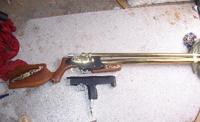

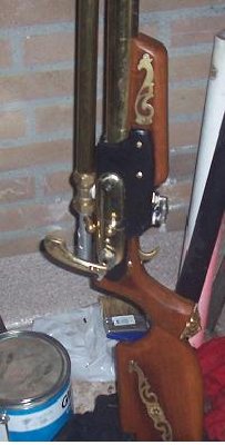

The basic components work.The hammer works, the valve works, it fires a powerful shot when I hit the valve with an actual hammer..The tool I mean.Y'all know what I mean by powerful, right...?
I just haven't tuned this hammer to this hammer valve.
But that is not a problem.It's only down to the hammer weight now.
I won;t be adding a scope any time soon.I need a very good deal on one, else it's just iron ( well brass) sights.
Thanks for all the compliments.I never expected it to turn out THIS good.
I tried, nevertheless.
Did I mention I paid less than 10 bucks for the thing so far??
All are recycled parts, yard sale finds and gifts.Even the lacquer was free..
The only money I spent on it was for the hammer-axle....Like a couple of cents...and I had to buy a wood plane..A cheap one at that.
Oh and the Tee..oh well...
Money well spent...

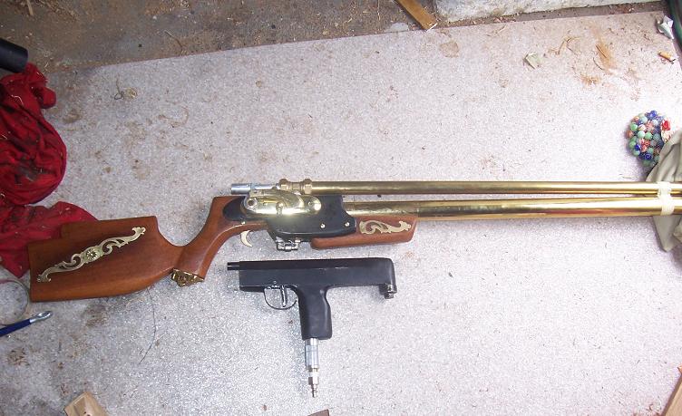

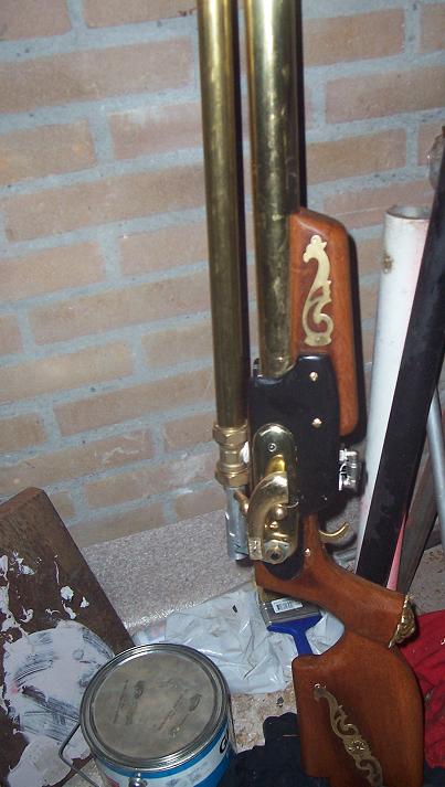

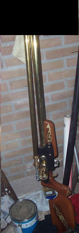

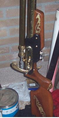

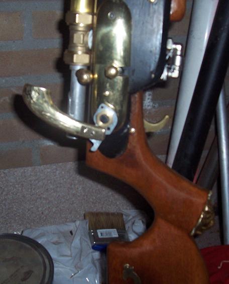

Here we go then.
Pictures of the assembled gun so far.I need to smoothen the new heavier hammer...
I tested the gun at 200 psi and got 15 shots out of it.Above 200 psi the lightweight hammer could not actuate the QEV.
Hence the heavier hammer.
I did manage to blast through a powerdrill casing though..200 psi out of a long barrel still does some damage.But no BTB kind of damage..
Heavier hammer is as of yet, not tested.
I'm quite convinced it's enough for 300 psi at least.
The goal is 600 nevertheless..No I might need a stronger spring, or an additional one..The number of shots I got from just 200 already makes this a fun gun to shoot.The first 5 shots seem highly consistent...

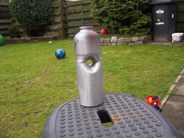

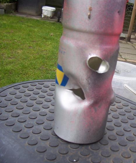

I'm not sure, not that hick though.Wow! How thick was that bottle?
Probably 1.5 mm.
Imagine the French use this as a pressurevessel...
It was the only thing around I could destroy,....well...I've got some furniture board, but that's hardly impressive.
Today I'll test her some more.
the damage was done by the 4th and 7th shot...all from one chamberfilling...Just think about all the potential a single shot gun wastes!!
