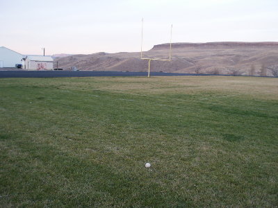

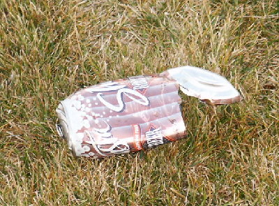

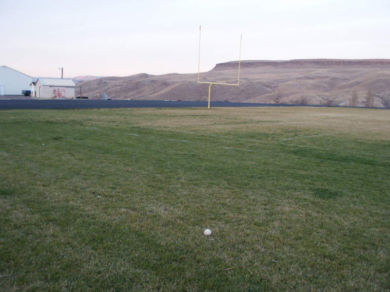

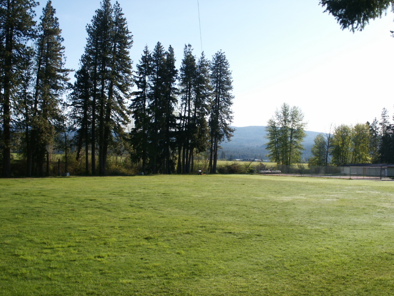

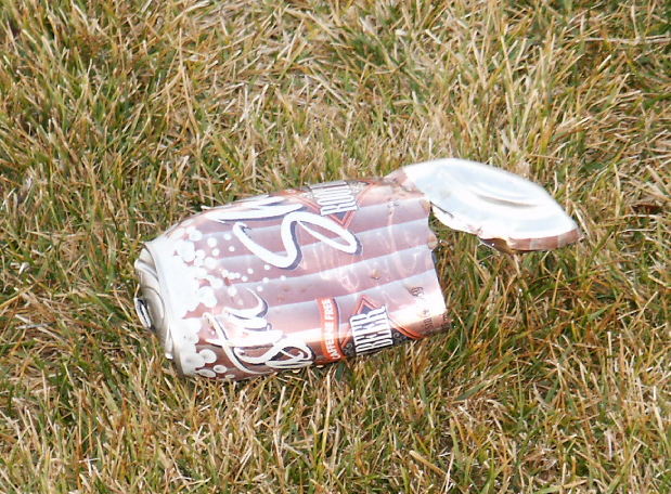

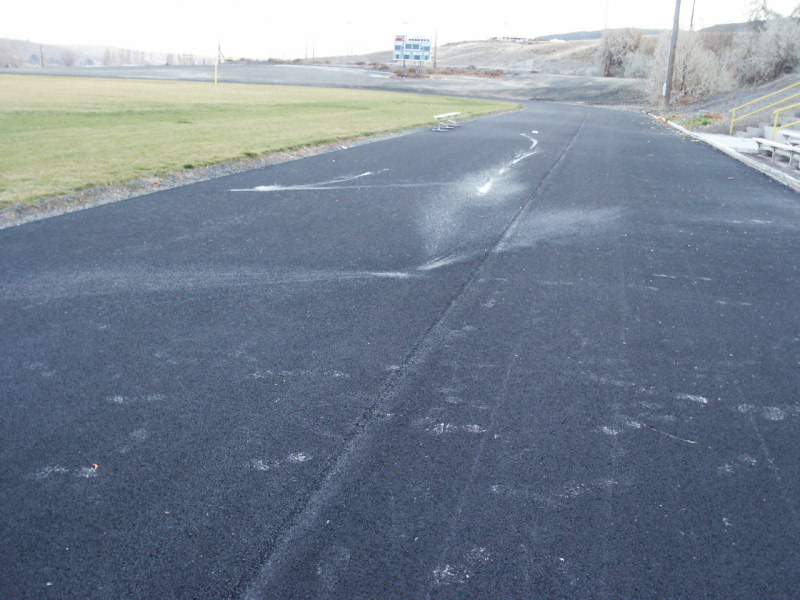

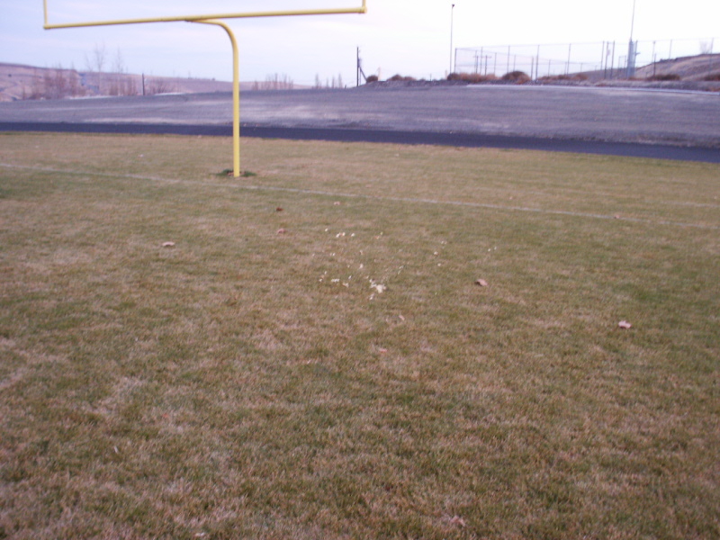

When I make range statements, it's because I have gone and found the landings. It is why I haven't made any golfball range claims yet. I simply haven't found any I shot for distance. Spuds, apples, shirts, bottles, sodas, etc are found and measured. It should be the minimum standard for distance claims. If you claim a distance, please mention how you found it as well as the condition of the projectile.
A full Gatoraid landing near the 50 yard line and then bouncing another 15 yards.
The baseball curved and didn't make it as close to the endzone
A heavier full pop didn't make it to the far endzone, but was close to the 50 yard line.
Apple landing in the end zone.  Launched from the shop, over the gym, parking lot, outhouses, bus barn, other goal post and out here.
We didn't retrieve them because we had a small obstacle in the way.
We launched spuds and golf balls over the trees at the end of the field.

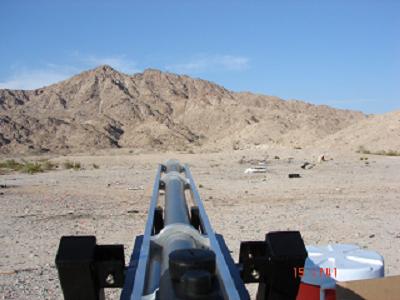

velocity3x
Posts: 828
Location: Yuma, Arizona
Technician1002 wrote:When I make range statements, it's because I have gone and found the landings. It is why I haven't made any golfball range claims yet. I simply haven't found any I shot for distance.
I certainly understand that. The ridge line in the pic is a measured 1,200 yards down range. GB's are still climbing out when they cross the ridge line and disappear on the other side. I'm not about to go looking for them and until I do, I can't make any distance claims. :wink:
1200 yrd range.JPG (24.34 KiB) Viewed 3951 times
