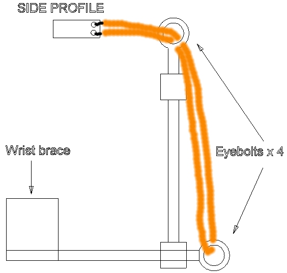

one more question if you don't mind, a lot of your more 'brutal' slingshots have the band stretched over a longer distance, so the elastic can be stretched further. Is this just equivalent to using stronger bands or is there a furhter advantage, I'm guessing for yourself you have run out of stronger bands to use but I'm sure that won't be a problem for me yet.
Anyway here is a diagram of how I might modify your design to give an extra bit of 'stretch room' for the bands, do you think it would offer a significant advantage over just using a thicker band on the original design?
I'm in the UK so there are no issues with wrist braces, yet. this one would use a brace similar to that seen on the Barnett black widow, which I used to have as a kid.
