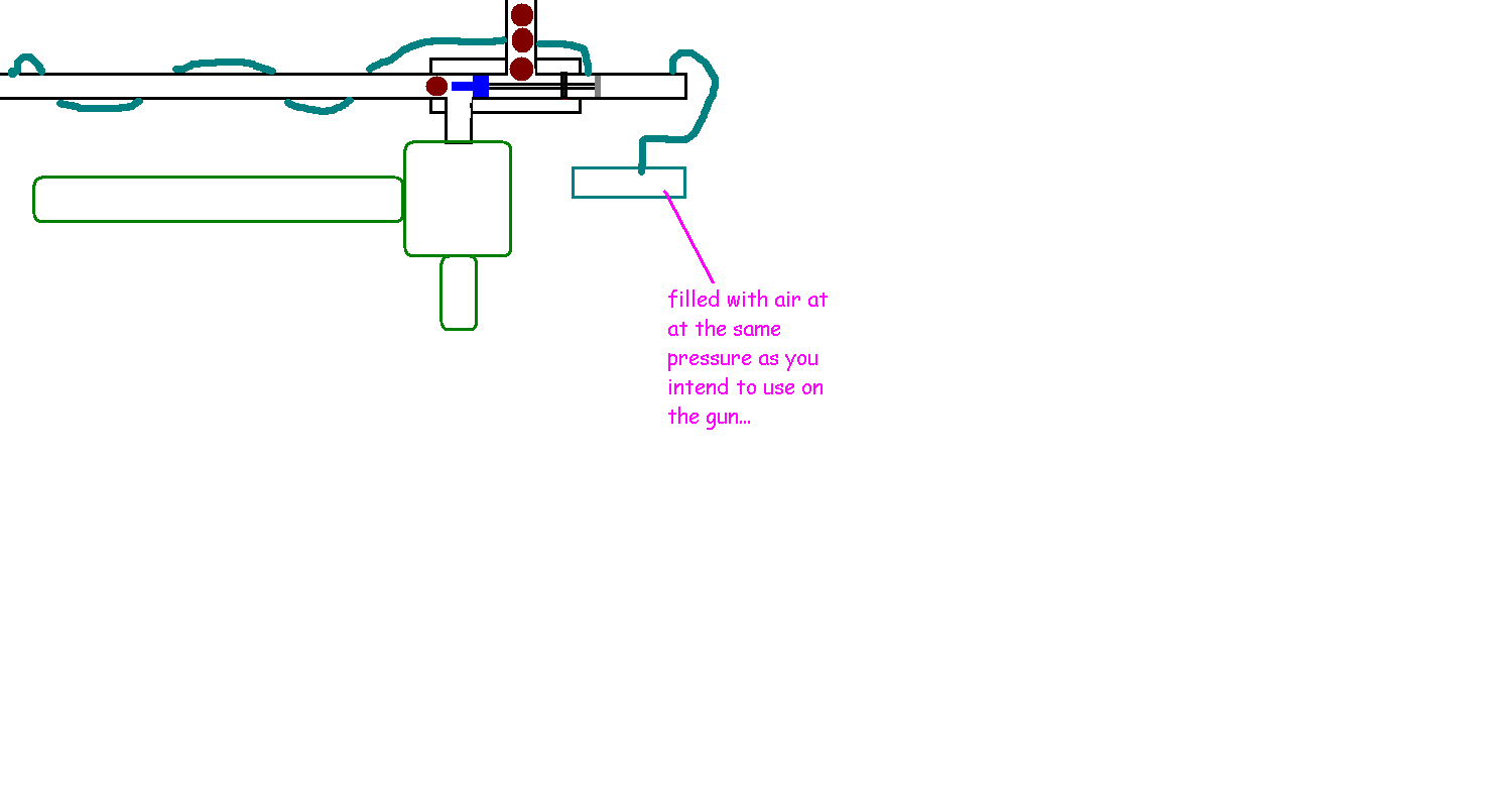

hmmm... I think this could be use to get rid of that air-ram... it's pretty self-explanatory I guess...
there is a T near the muzzle and tubing runs from it to one side of the air cylinder... the other side is already pressurised to the same pressure as you intend the gun to be at or slightly higher
when you fire the gun the bolt stays in place but once air from the muzzle reaches the air cylinder the bolt moves back
Well...let's..ehm..see
There are several ways of doing it.
The basic idea of using a muzzleporting to recock could even be done in a pistol sized...ehm...launcher.
And I have indeed pondered the use of hoses so the moving parts would take up less space on the gun.If I hadn't just happen to find the right parts I would have probably.
But we all know this crowd just loves pictures, especialy moving ones..
I'm guessing moving external parts will be appreciated better in the case of a relatively new concept.
It makes it easier to get.
