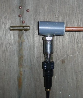

My attempts at prototyping this design didn't go too well, but combining the valveless idea with cartridges was too appealing an idea to give up so gave it a bit of thought recently on how to improve it and came up with pretty much what I had proposed initially. I decided to give it a go for 0.177" calibre with a 6mm tube cartridge, and results so far are very encouraging.
Here are a couple of videos at 420 frames per second, with the cartridge unsupported it will happily put a BB through an empty soda can, in the next shot the cartridge is resting against a weight and this way it punches through the bottom of a soup tin.
Here's the cartridge popping out of the breech at 1000 frames per second, comes out with quite a bit of force so it should have no trouble ejecting itself and pushing a bolt back far enough to reload a new cartridge.

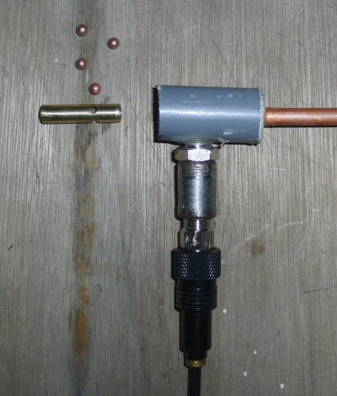

Here's a detail of the breech, cartridge and ammunition, hooked up via remote line to my paintball tank:

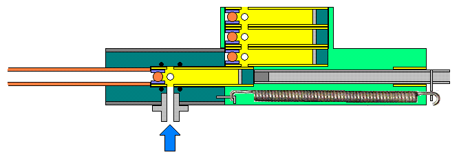

That's the idea, I'm going to graft a spring loaded bolt to this breech and see if it can handle cycling the action and move on from there.If this works...are you gonna finally make a complete gun for it?
This is vaguely what the test rig will look like (along the lines of my earlier prototype), I've gone for a tension spring for the sake of keeping things compact.

Sweet! That is gonna be one hell of a gun! Keep at it JSR!! and good luck!

Based on those videos, I think you have a very high probability of seeing some flying brass. Awesome!

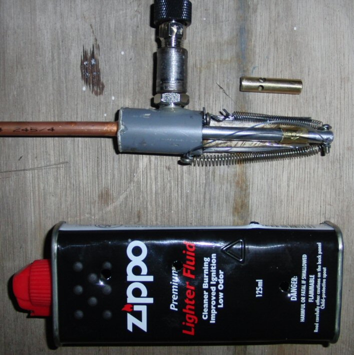

I've been doing some testing with the breech and it's extremely promising
With a single tension spring, the bolt was thrown straight out even after it stopped being under the influence of the projectile, fail but win
I added another spring and positioned a cardboard box for the bolt to strike but to no avail, it was still thrown out of its housing, then whipped away by the springs
I added a wire stop to limit the travel of the bolt, much better. Here it is with one spring:
... and dual springs at 420 frames per second:
Same setup as above at 1000 frames per second:
As to power, all the above shots went through one side of a zippo lighter fluid can and almost made it all the way through - not spectacular but good enough, certainly better than my first cartridge fed pneumatic effort that couldn't make it through a sheet of cardboard
one should consider that the "chamber size" is basically the cartridge, so while it is at high pressure there is a relatively tiny quantity of air pusing the projectile, perhaps a wider/longer cartridge is in order.
All in all, it certainly looks like it has enough power to work a magazine fed cartridge setup, as a proof of concept this thing is working remarkably well

wow, that is amazing, so much cleaner and more powerful than your first prototype. The ejection is so perfect, and the mechanism is so simple!
I love lamp
Instead of that mess of wires and springs, why not house the bolt in a half-pipe of sorts, with a compression spring, instead of an extension spring (which introduces the possibility of breaking both the springs and wire restraint all in one go)?
This is just a proof of concept prototype, for an actual finished launcher I'll go for something neater. This is only to see if the idea can be made to work.saefroch wrote:Instead of that mess of wires and springs, why not house the bolt in a half-pipe of sorts, with a compression spring, instead of an extension spring (which introduces the possibility of breaking both the springs and wire restraint all in one go)?
The cartridges are really the simplest thing to make, it's just a section of tube, sealed with araldite at one end and with a section of silicon tube epoxied in on the other, and four ports drilled through it.Once you're pretty satisfied with a cartridge design, you could order a bunch of them (or at least everything but the seal) from a machine shop.
As the seal releases the BB well below the 800 psi I'm feeding into this thing, I thought I've give it a go with a ball valve closer to the breech to see if it gives better power but judging by the zippo can penetration it doesn't make much of a difference.
