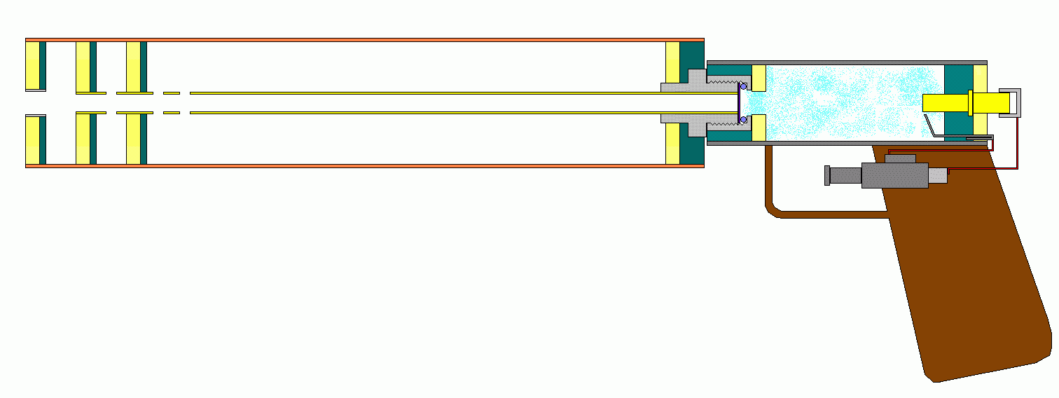

Here's what the completed project might look like, still not clear on electrode attachment.

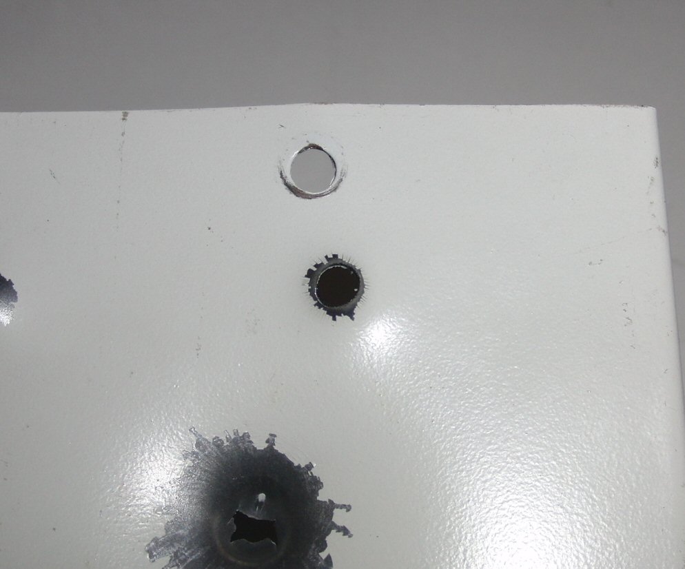

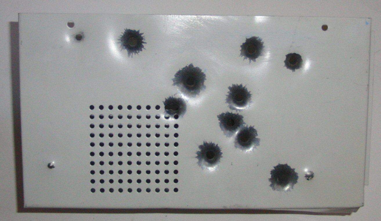

spurred on by the burst disk failure at 10x that left this thing intact, I went for 12x and HAHAAAA!!! 1487 fps with a 16 grain pellet!
Not 100% sure that's a reliable chrony result, but the loss of hearing seems to confirm it
Still won't make it through 2 sheets of steel though, but given the deformation of the lead on penetrating the first sheet it's hardly surprising. I tried with a 0.177" BB in a foil sabot at 12x and it punched straight through, you can see the entry hole top left in the first photo, and the exit hole in the second.
Yes, I really should make that suppressor before I go completely deaf
Edit: in order to put the chrony result into perspective, I did some test shots against the same targets with the same pellets fired from my fully charged FX Monsoon which was doing 850-900 fps, it only penetrated one sheet and the dent left in the second sheet was considerably smaller than those left by the mini hybrid at 12x, so I have no reason to doubt the result. That's over 75 ft/lbs, oh yes

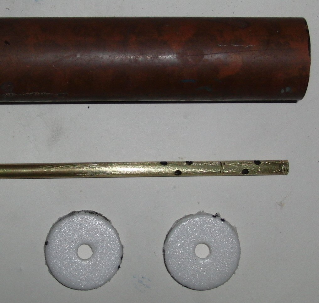

Here's what I'm playing with right now, the muzzle end has been ported, you can also see the copper tube that will be the suppressor body and the foam disks that will be used to cast the epoxy baffles.
As you can see I've been quite restrained with the porting, mainly because I don't want to hurt performance too much. The hope is that the relatively large suppressor volume and multi-baffle design, together with the copper tube and mesh packing acting as a heat sink, will be enough for good sound suppression.
The pipe was salvaged from some old boiler piping at work, it's duller than the Twilight seriesAlso you'll want to make the exposed copper on the inside of the suppressor as dull as possible. Shiny copper is an excellent heat reflector, even though it conducts well in direct contact.
