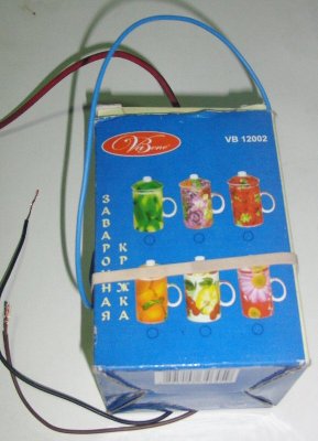

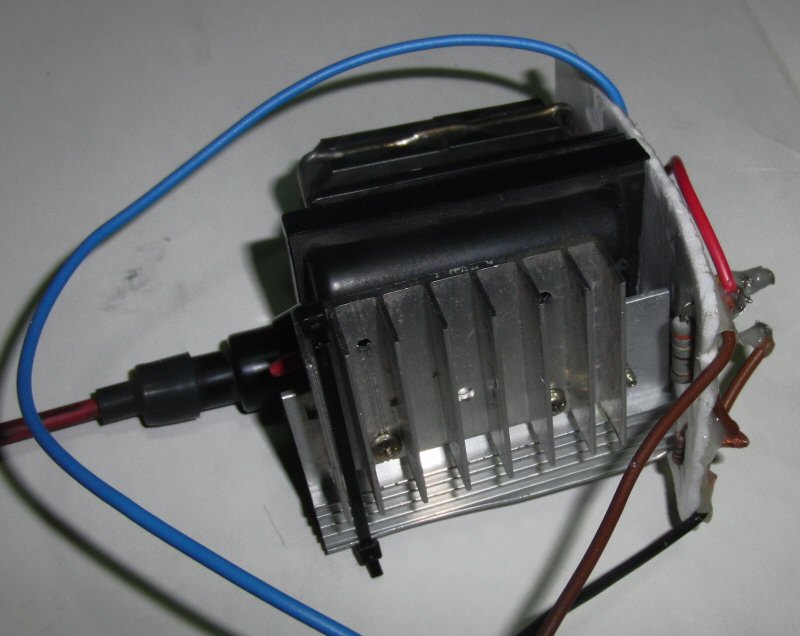

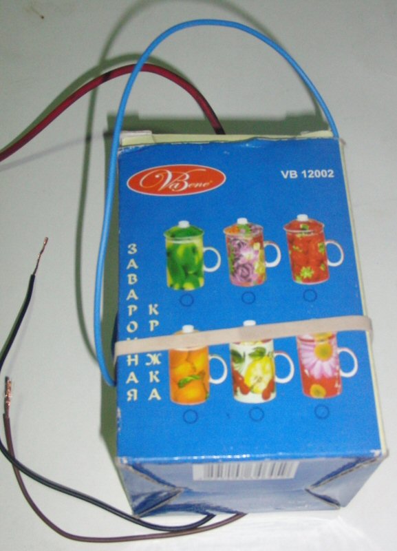

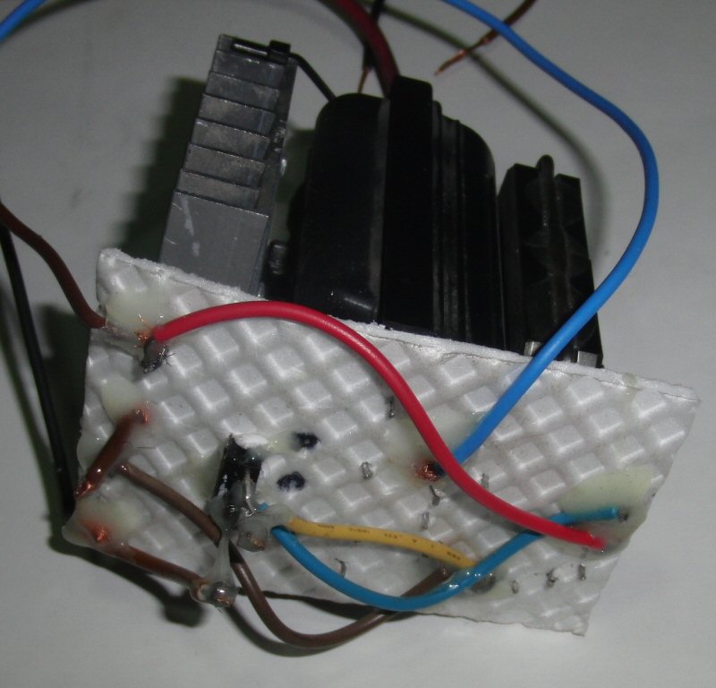

Nice! By the way, here's how I "neatened" my setup - twisted wire and Araldite "soldering" then I chucked it in a small box which originally contained a Russian mug :roll:
