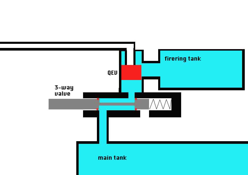

@nadjatee
In your first post starting this thread, you stated that you were going to build a PISTOL.
23 minutes later......
In your second post, you state that rather than build a pistol, you've decided to build a RIFLE.
How can anyone help you when you obviously don't know what exactly it is that you want to do? Perhaps you should decide on a course and proceed in that direction........then ask for help.

I decided rather to make a rifle then pistol at first because bigger was anbit easier at first, and hey, Asian people
are cool! Lock, I just needed the valve, checo two pages ago, i designed all that alreafy eith really bad diagrams

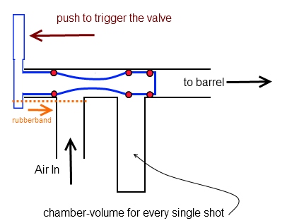

Aside from the off-topic and the mass of different diagrams of different valve's, I understood you in that way, that you are looking for a valve that:
-is just out of one unit (so no qev or other piloted ones.)
-will have enough flow/speed for small projectiles
-is capable of semi-auto-action
having this in mind, I would recommend you the following valve, it is basically a 3-way valve, that becomes unbalanced and use the "Tech's-QDV-style-effect" to force the valve open.
I use it as a piloted in this project, and it should work fine for small projectiles, at least better than a commercial 3-way (it has full-bore-flow, once opened).
the negative aspect is you will most probably make it on your own, but maybe I could help you with that if you decide to build one.[/url]

How the one you showed me works
nope it works exactly the way you want it. You pull the bolt back and air rushes through the side port into the barrel
basically speaking it is just like this design posted by JSR
But it has a separate port for the magaize

Remember the air will push on the face of the piston with high force when triggered open. Be sure the piston has proper limits to motion or you will be searching for it behind you.
